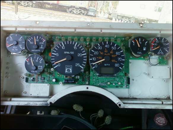

Can you post a picture of this thing here. If I indentify this dashboard may be I will help you -
Thanks for the advice-
It is a mechanical oil pressure gauge. I will pull the gounds off the firewall here in a minute and clean them, then reinstall. I have my camera with me, so I will take a picture and load it here in a bit. -
I used a multimeter and am getting a good ground into the cluster. I also poked around a bit in the cluster and got grounds throughout.
Here is a picture, it is from my phone though, so it isn't that good.
I'm worried I have either a bad cluster or something is wrong with the ECUAttached Files:
