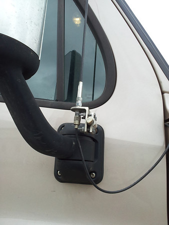

    The coax in my cascadia is bad so, when I was only a month into trucking I was sold this antenna setup:
    Coax run straight from the radio, along the dash and out the passenger door, about 9 or 10 feet long (I did not measure it). The coax is Tramflex RG-8/x Foam 95% Shield stranded center.
    The antenna mount is a single stud perch.
    The antenna has no markings on it. It is 4' and I think fiberglass.
    I installed the perch myself and the guy at the CB shop came out and tested the antenna on it with his meter. He kind of gave a "mppfff. Well it should be good enough for your purpose." response to what he saw on the meter. I did not know enough then to ask further questions about that.

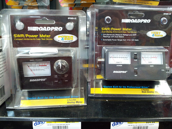

    I was wondering if either of these roadpro meters (free to me with pilot points) will do an adequate job for my limited use testing of my setup? So I can see what it is doing before I start modifying it, and after.

    Well im defiently no expert. But for starters id chuck your coax and get a new 18ft. then i would probably just get the cheaper swr meter. You have only a 4watt radio so i wouldnt think you would need the other. Check your reading with new coax then determine if ya need a antenna. On the swr, you want less than 2 and a 1.1 is ideal. Good luck!

    18 foot is useless ... nothing WRONG with even cheap meters I use them all the time ....
    The antenna is the key ..... if it is no right nothing works ....
    here is a good meter ..... and a cheap one .... both work

    Rule of thumb. If its 3 feet between your radio and antenna. You need 3 feet of coax.
    Truck driver rule--- 18 feet. I guess so you can use the extra to hang yourself. I dunno.
    Have you ground checked. Might be part of your problem

    Am I seeing correct? That's a Francis antenna ?
    If so. Trying going to a good metal type.
    Francis is an excellent antenna. And usually gives great results on any SWR meter. But it does have its Own issues.

    Maybe that was confusing the way I typed it. The preinstalled coax is not just bad it's broke. So I ran a new wire along the dash and out the door.
    Is Tramflex RG-8/x a decent coax?
    I was wondering about the ground as well. Perhaps it has some thread lock on the threads from the original bolt.
    How do I test for a good ground?
