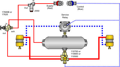

    I have a 06 freightliner classic xl and my truck brakes on isn't locking when I pull the knob. I hear a real faint air releasing. I change the valve that's connected to it and that isn't the issue. I'm lost now.

    air brakes.gif When you pull the knob it dumps the air from your brakes allowing the spring brakes to be engaged, I really do not recommend messing with the spring brakes if you do not know exactly what your doing. Check them to make sure the TEE bolts are not installed on the brake chambers. Past that if your release is not dumping the air in the system, might be time to have a mechanic take a look at it. There really is not too many pieces involved in the air release side of the parking park.

    Likely your quick release valve. The air release you hear should be short and sudden, dumping all air on the "out" side of the QR valve as soon as the brakes are set. That's where I would look first, especially if your brakes feel like they're operating normally otherwise.
    You should have a 3/8" air line going to the QR valve. That is your signal line. I would remove that line immediately after setting the brakes.
    If there is no air there, loosen one of the brake chamber supply lines. If there is still air there. R&R the QR valve

    I don't think QR valve is bad. I just replaced it last summer because it was leaking bad. It's been fine since. And I just replace a line from the chamber going to the valve couple months ago because the line was rubbing and leaking.
