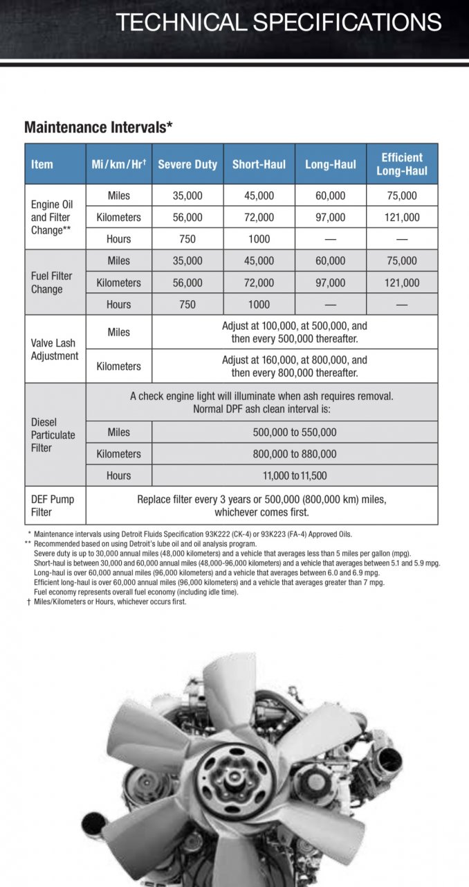

    I would venture a guess that they would go by the book on service intervals so they don’t screw up the warranty. So at 191k it’s probably been serviced twice if they did it at the Detroit recommended interval of 75k miles.

    To go to 75k oil change interval the truck must be in *Detroit’s lube oil and oil analysis program* which require oil sample analysis every 10 k miles(according to Detroit website) . I don't think they will do that. Most likely they will do 35k oil changes to keep the warranty.

    Doesn’t say anything about that here.

    Yes. Bottom there is a note ** Recommended based on using Detroit’s lube oil and oil analysis program**
