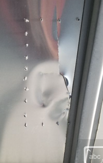

    Yeah go to your local truck parts place or maybe even a trailer place. They should have thin aluminum sheet metal patches they sell that are about 12"×12" square and I think the thickness of them is .030 or maybe .040 They may even have them in other sizes and shapes. It will have a really good adhesive on one side you just peel the wax paper off and slap it on.
    Now you might need to take a hammer & dolly and with a helper on the inside of the trailer and you up on top hammer the sheet metal as flat and smooth as you can get it before applying the patch. Then maybe some tin snips to trim the patch or you can probably just slap the whole thing on there without any trimming.
    Some people drill holes along the edges of the patch after its on there and put pop rivets in them then I guess they silicone it. I didnt do that. I didnt want a bunch of pop rivets in mine. The adhesive is really good and it never did leak or come off for a couple of years before I got rid of that trailer.

    I had that thing patched up yesterday at a shop in OHIO. Piece of aluminum riveted down and some seal around it. I did not object to the method, especially that the guys were available to take me right in and I was still able to find a load back to WI - not losing revenue.
    Overall job was $120 and they were kind enough to sell me an almost new crank handle for $10 - mine was about to break in half any time. The fix ain't pretty but I chose a decent load over aesthetics...as long as it holds up...I'll need to get a ladder and check it every now and then...but that's what's you get with any kind of patch.
