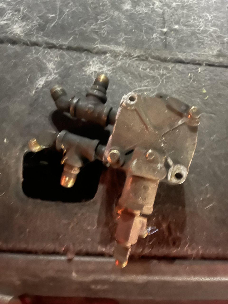

    I found the culprit. This is under the fifth wheel
