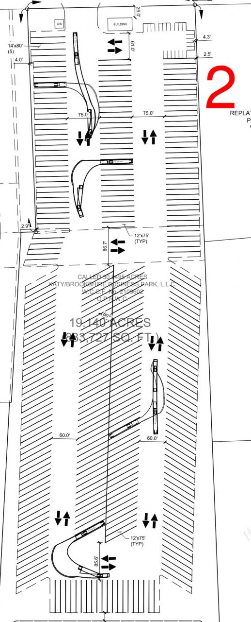

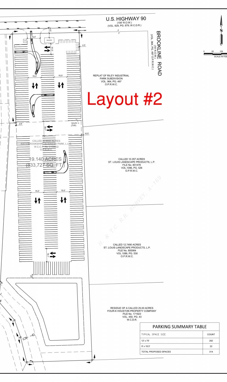

    I'd still go with #2. I see that the east side of the angle parking isn't see side, so..unless there is a restriction preventing it, it should be converted also. I like #2 also, as you have a variety of spots that could accomodate vans up front, flatbeds in the middle and sides of the lower section, and wide loads could be parked in the direct back as you've left a good 85 feet of clearance to use to put those loads in the holes. As long as the vans don't steal the flats area, we'll be good. Don't forget that any section, not big enough to hold a full size truck could be cut up to allow Bobtail vehicles parking or hotshot only slots, so they'll stay out of the full size slots for the full size trucks. Thanks for taking the feedback.
    Yep, you left enough information in that for an old draftsmen to figure out where it was, thanks to modern technology and Google Maps :)
    NoBigHurry Thanks this.

    Blind side backup in #3 layout?
    Are you selling pay per view subscription of the parking lot live action?
    Are you trying to compete with that Mira Loma CA Flying J?
    Please...
    CAXPT Thanks this.

    I like this new #2.

    Surprised how many are nose in. Must be polite Canuckistan.

    I'm going to be the oddball here who brings up the "off the wall" stuff that hasn't been mentioned specifically yet.
    (I'll admit, I didn't read everyone of the 55 posts but I did try to read the majority of them so I may be repeating or possibly missed something)
    1) Bobtail spots. There is a part of our industry that runs "power only". Or just need to park his truck for the weekend or week while on vacation etc.
    2) I know over length trucks were mentioned .. like 80 ft long etc. But what about over size & over width? Maybe a couple of spots that are 17 wide for mobile home or other wide loads?
    3) Spots for pilot cars etc.
    4) I know some have mentioned idiots & lazy people but I didn't see anything about all the new guys (which granted, are included in the idiots & lazy) but we have more new drivers than ever. They dont have the experience to maneuver. Some dont even understand physics. I've seen some guys turn around 2 or 3 times just trying to get backed into a place. When I say turn around, I mean, they will be facing west initially & will wiggle & wiggle until they have turn in a complete circle twice trying to get into a spot. But that's what we have out here today. My point? At least 12' spaces. I know someone mentioned that you can have 11.5' spaces if you do 90 degree spaces. Some cant get into 16' space without banging up the next two trailers on either side.

    Personally I'm a fan of #3 or #2 on the redraw I prefer angled parking in general. I agree with @Bean Jr. comment, I haul containers, and certain chassis, they don't turn/back very well, a 20' on a shortened 20' chassis can easily get away from you in jackknife backing situation and actually make things worse, and other chassis, like a 3 axle heavy haul container chassis, they simply don't want to turn while backing and can be a real bear to jackknife into a spot.
    Also, as I look at where you are planning, there are multiple customers in that area that will use containers, so you're going to have a lot of odd size trucks coming through. Also, I wonder if you'd have a better location for services at Pederson Rd vs Brookline, looks like a lot of residential and an airport at Brookline

    Number 3 but change the outside parking to driver side back in. Not blind side.
