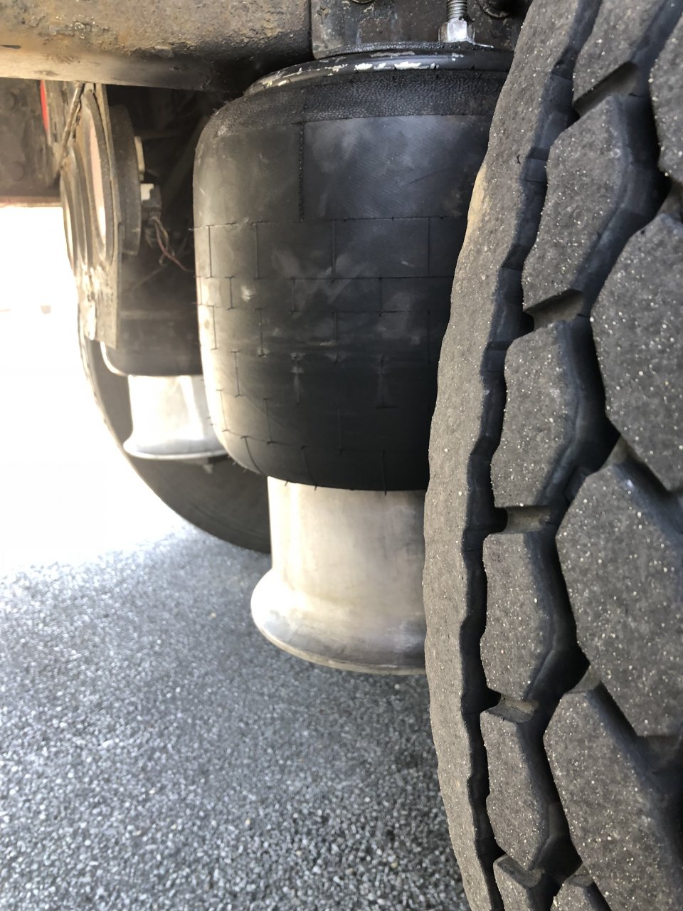

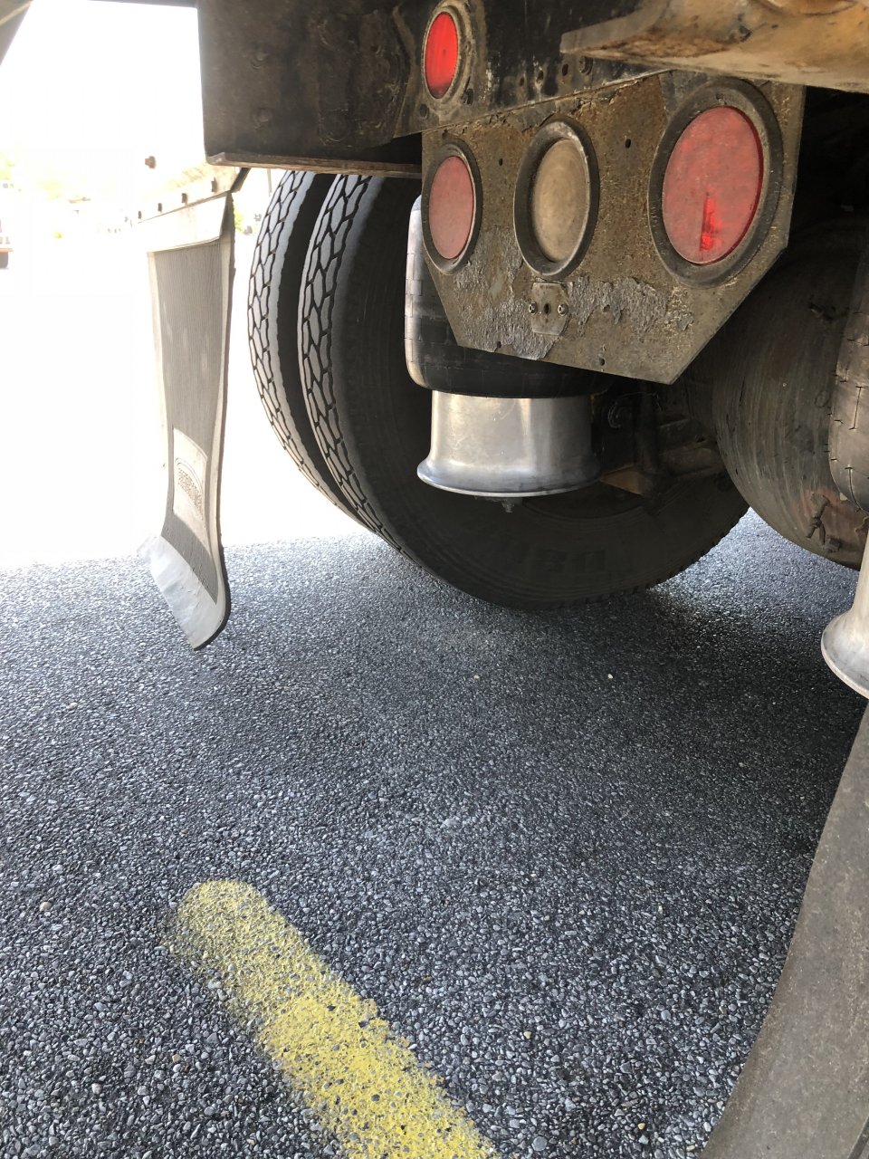

  11. Rideandrepair
    16,526
    53,939
    Aug 8, 2015
    26FC15B7-ED51-4686-B171-75ABC84E931B.jpeg 426C2A92-439C-4449-84E0-45C970492451.jpeg Here’s an example of mine, they were over inflated. Adjusted them once and they returned to this again. Thought I needed a new valve. Decided to adjust one more time.Luckily they stayed at the right height. The valves are sensitive and patience is needed when adjusting.
