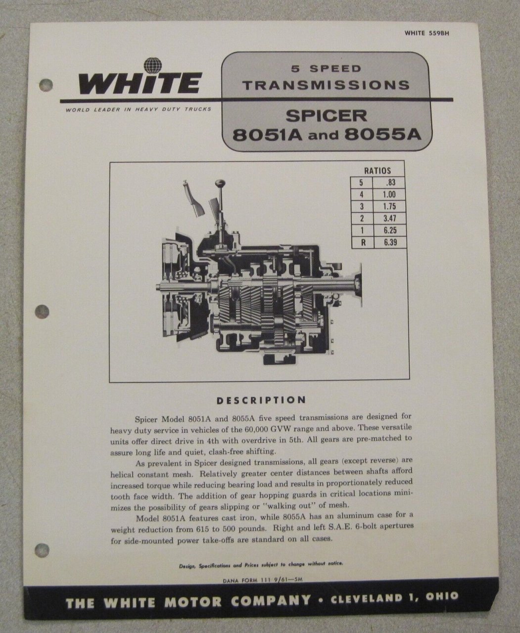

    4D555862-9233-4616-B936-213BB6BDCFFF.jpeg CE3DD9BB-9817-4F35-92FF-F6D3DFA901CE.jpeg
    5 and 6 speeds in big trucks have been around a decade and a half longer then the 13 speed road ranger.

    Don't forget the 7 speeds with their 4 shift gates!
