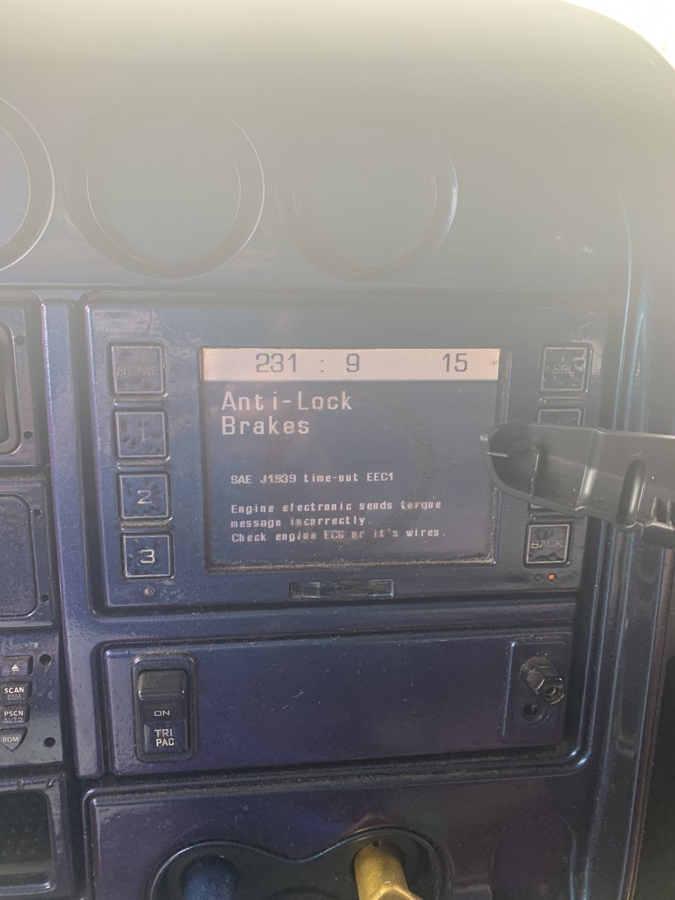

    Has any had this message on there truck. ENGINE ELECTRONIC SENDS TORQUE MESSAGE INCORRECTLY.
    CHECK ENGINE ECM OR ITS WIRE.

    Had a kw that did that to me but was a automated manual and was the key switch
