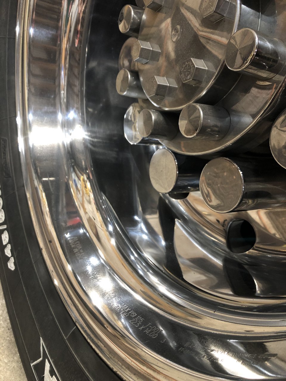

    Big_D409 what colors do you usually use when cutting your aluminum? I go with Brown, light green, and blue. Reason I ask is I see some sorta Dark green that polishers are using now, suppose to be a topcoat shine. Never used it, and I dunno if it works any better then my Blue rouge topcoat.

    The aluminum I have been using the kit that Evan Stegar sells. Personally I haven’t gotten as rich a shine as if you add the white wheel and blue bar, but it still lasts about the same.

    Ok cool, looks nice. I will just stick with the blue bar on the aluminum. I’m happy with it and have been using it for years. It tends to give the dark luster that I like. Unfortunately, we are in late December right now in the northeast so no polishing or waxing until spring. And once spring does come it will be a tough cutting, high speed, finger cramping road back to dark lustered aluminum. Winter is the absolute worst thing for polished aluminum.
