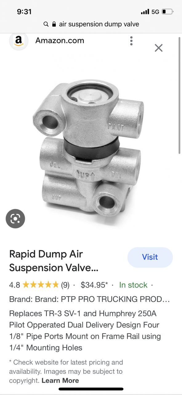

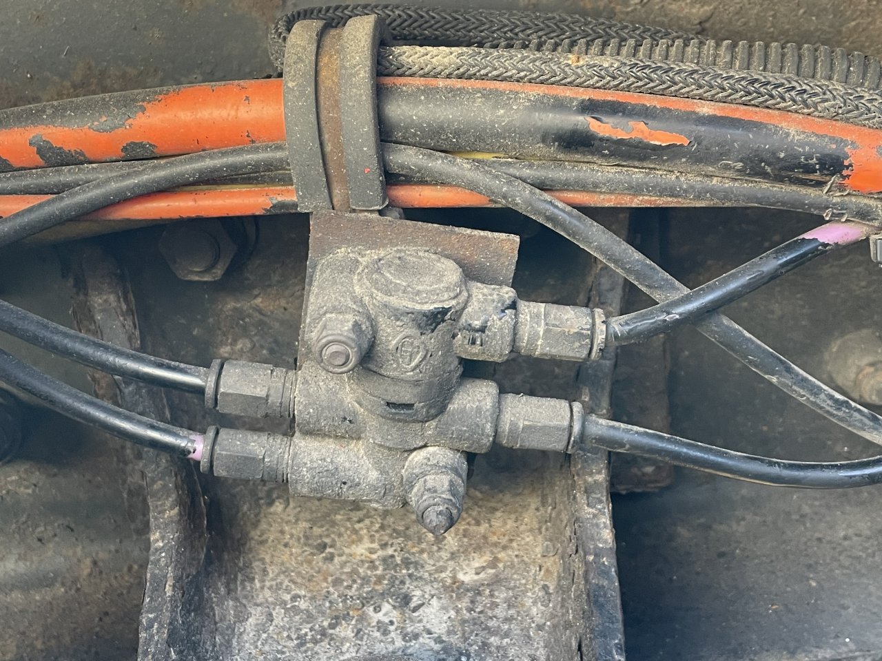

    This is the dump valve on my truck, just need an air operated valve to go with it….

    You could just call and get the factory dump valve and switch
