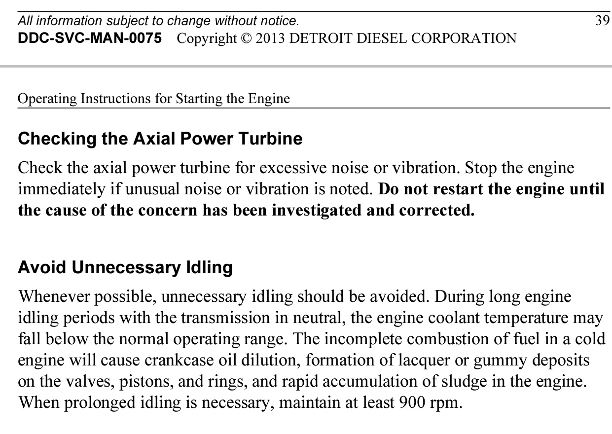

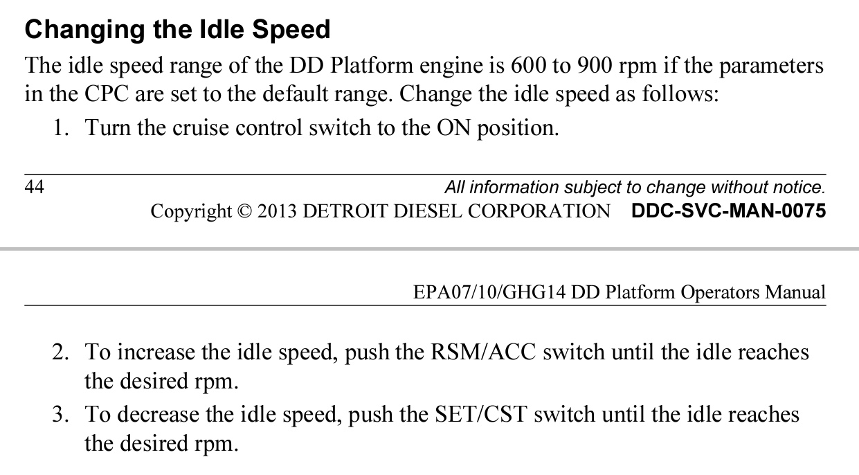

    For the DD15, the maintenance manual says that idling at 900 RPM should be enough for heating purposes when temperatures are over 32 F.
    In my truck, I need to set the cruise control to keep my truck from turning off after 5 minutes. With the cruise control on, the engine idles at 900 RPM.
    Edit—
    There might be a way to change the RPM idling speed on the DD15. Document below.
