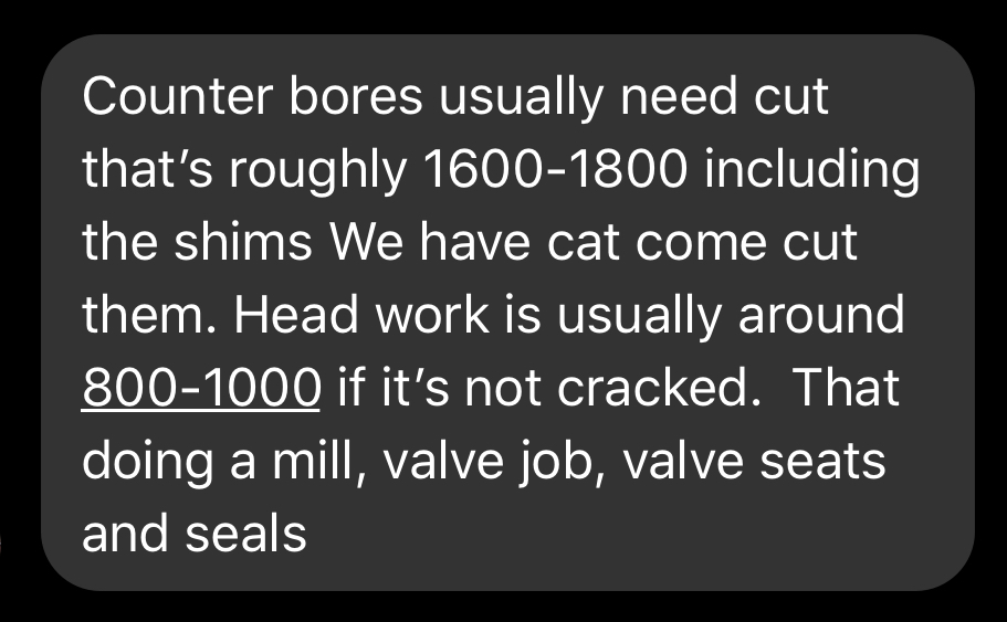

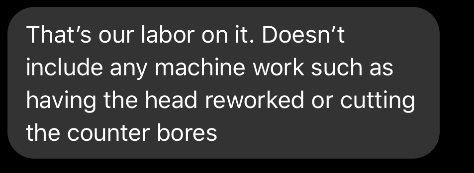

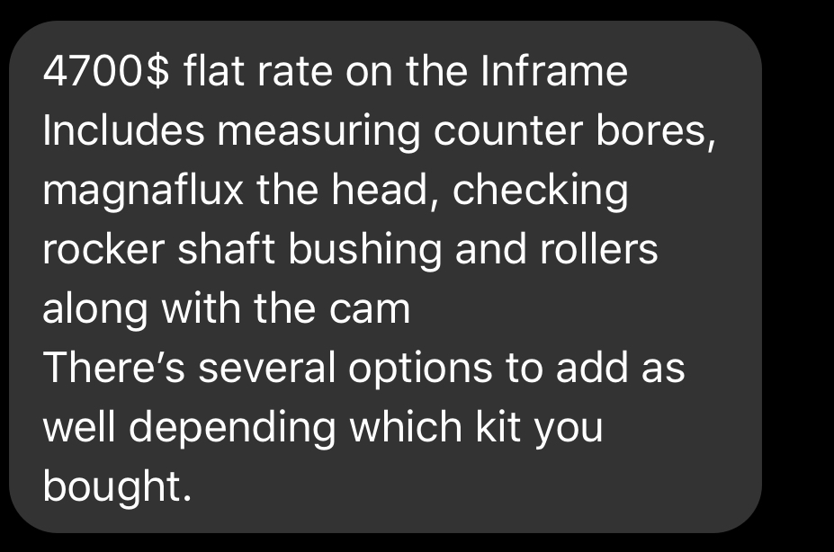

    So here is what I am being told the cost to fix all this madness is.
    Rideandrepair Thanks this.
  4. AModelCat
    28,891
    154,886
    What was the story that lead you to going with a rebuild? What tests were done? I would seriously consider a compression test before dropping any more cash.
    Think back to basics - the fire triangle. Air, fuel, heat. If you've got good air flow in/out of the cylinder, good compression (compression is your heat) and fuel, it HAS to do something. At this point (and in my own, personal opinion) not nearly enough has been checked/verified to make me lean towards a rebuild yet.
