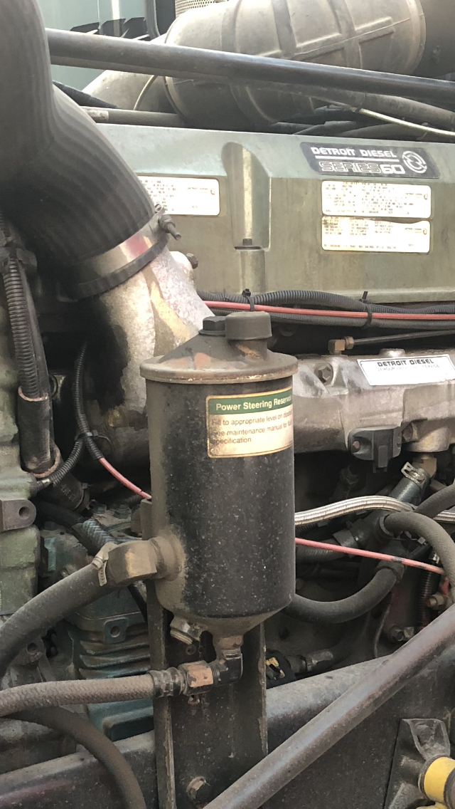

    D1CB187A-F07F-42E9-9FBC-56D845B0665C.png Here’s a pic of my Detroit. See the black hose, connected to the silver intake manifold. Take it off and spray it straight in the manifold.
    lwlevens and Gix1k Thank this.
