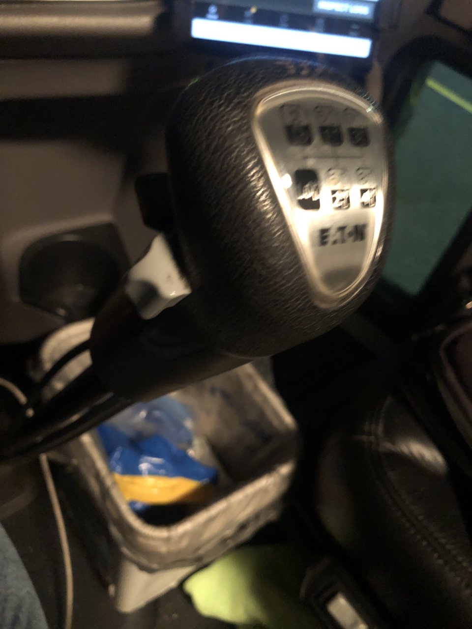

    I run a lot of mountains mostly heavy so that’s my excuse for having a 18 along with a 3:55 axle ratio. Climbing it’s nice to be able to drop in smaller increments and keep my rpm’s where I want them. Never liked a 10 speed mainly due to the shift pattern. 13 & 18 are like shifting a four speed
    Yesterdays delivery in Yamhill, Oregon proved that I had the right tools for the job. Not so sure a regular fleet truck could have pulled it off.
    One long climb up a gravel winding road I’m guessing was over a 10% grade and I was loaded to about 78k. Just a farm in the middle of nowhere Oregon that seriously put me in panic mode because I didn’t think I could climb it. Luckily I got it down shifted to 3L without stopping and just kept the rpm’s @ 1,500 and made it.
    Farm on the top of a mountain..go figure :) IMG_6417.jpeg IMG_6408.jpeg IMG_6407.jpeg
