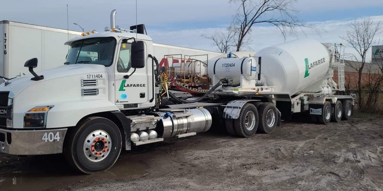

    that is quite long wb for construction work.
    is this necessary for canada some kind of bridge law?
  7. AModelCat
    21,374
    97,078
    We use all kinds of setups in Canada. You can probably haul more on a 6 axle setup like that than a straight truck. This is the only application I had ever seen a lift axle be used in Western Canada. mk_ready_mix_banner_home.jpg

    Its law to have chains on a truck from October to March. Depending where you are in Canada it can still be quite warm during that time.
    I've seen concrete being poured in -20 or colder temperatures. They tarp in the entire area and use diesel heaters to keep the temperatures above zero.
