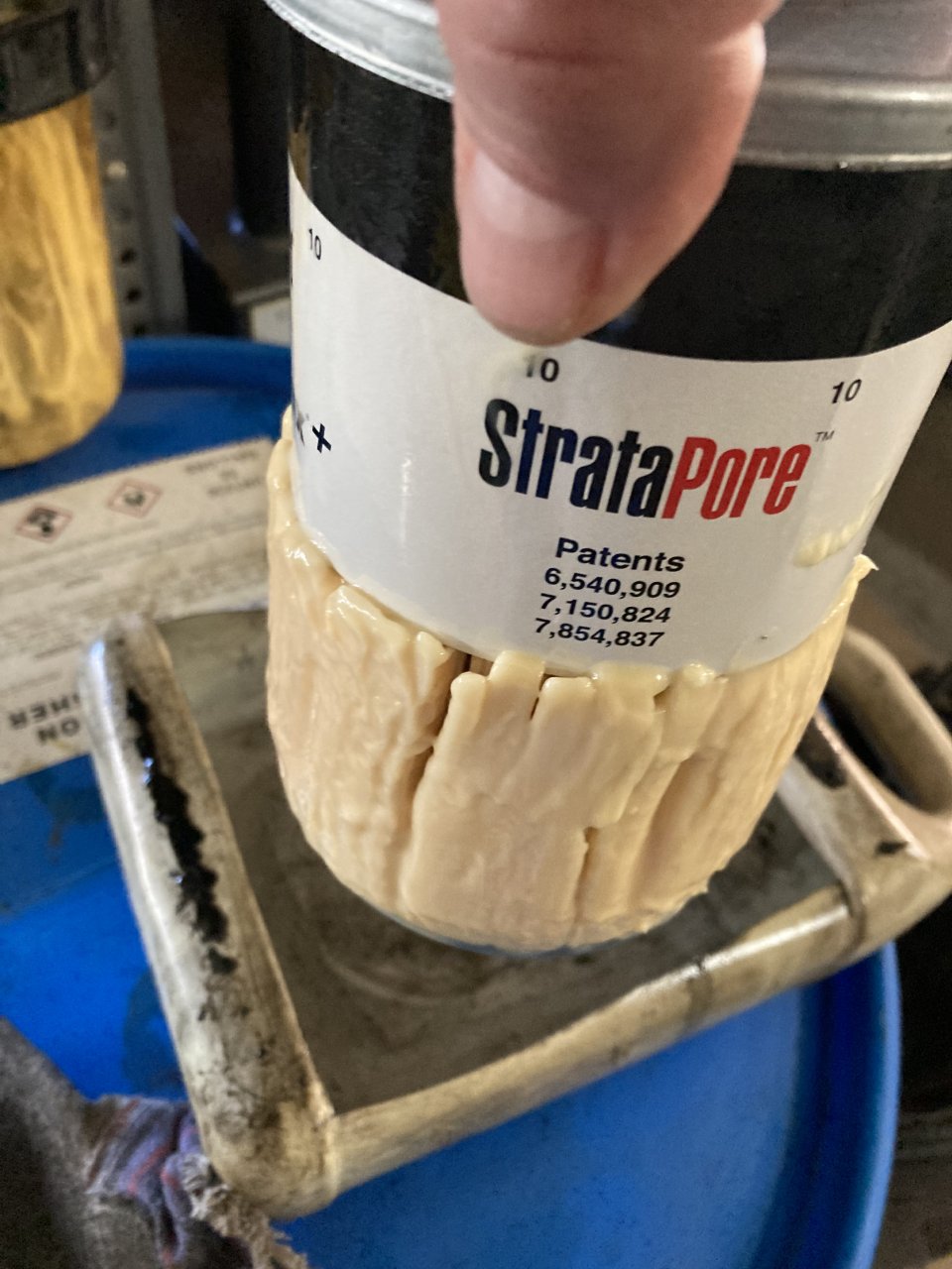

    I agree but when the paraffin wax plugs up the filter like this it’s time to throw away the filter.
    This was taken two days after I changed it and it was draining in a heated shop.
