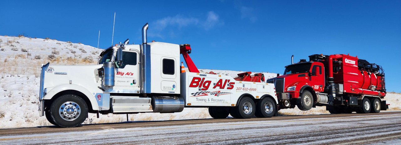

  11. Animosus
    Animosus Heavy Load Member
    727
    2,864
    Dec 7, 2015
    SE Wyoming
    Hot shots and squiggly fuel.
