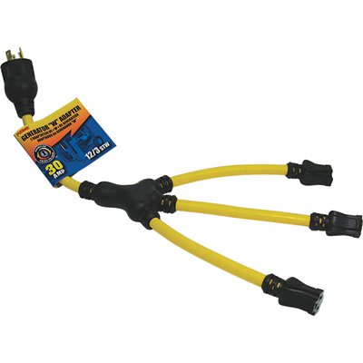

  11. Jasonar15
    Jasonar15 Medium Load Member
    669
    519
    Aug 6, 2017
    1. I placed generator on catwalk or you can find a box to mount to frame.
    2. I made a 30 amp cord (did not buy one due to end being to big) leave one plug unattached.
    3. Drilled hole under side box that went into side box
    4. Raised bed and drilled hole from side box to under bed.
    5. Drilled hole from under bed out to truck cab.
    6. Ran power cord through holes.
    7. Attaches male end plug to generator side and female on truck side.
    8. Plug in 30amp plug to generator and plugged 110 volt adapter to female plug in truck.
    9. Turn on generator
    10. Plug in heater, a/c, phone charger, tv or whatever you want and enjoy.
    30amp to 110v adapter attached. Can buy at northern tool.
