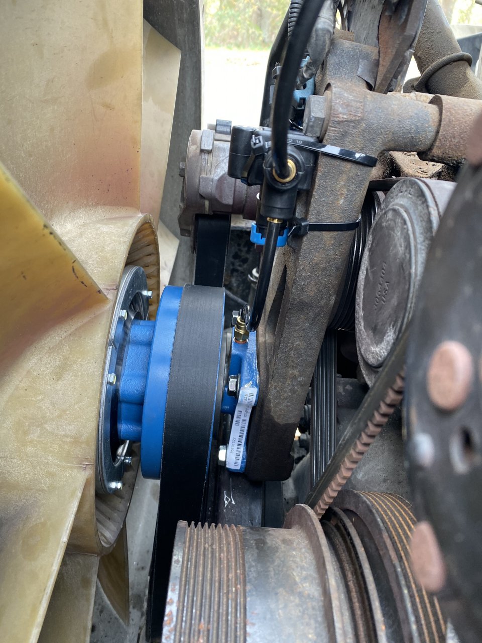

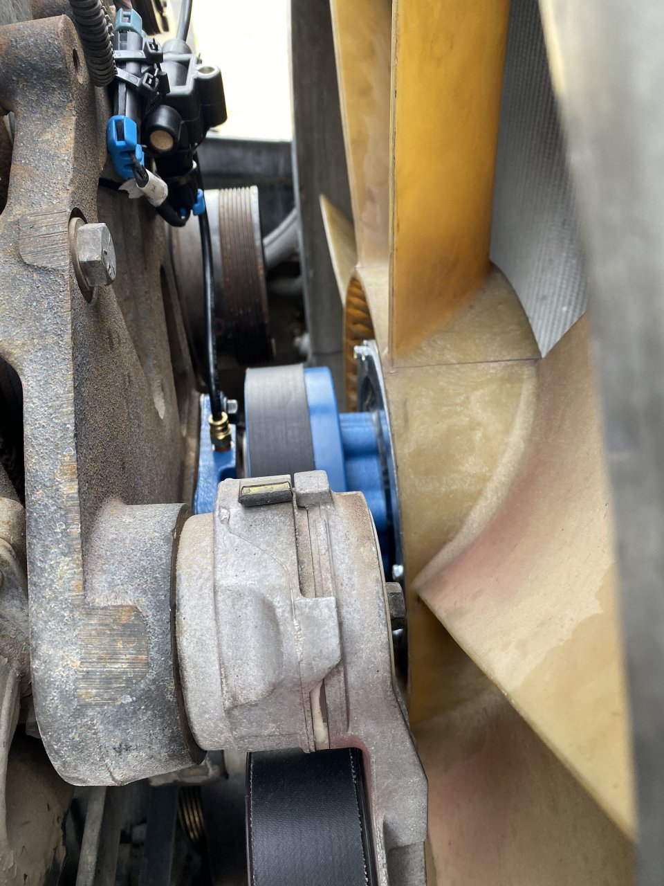

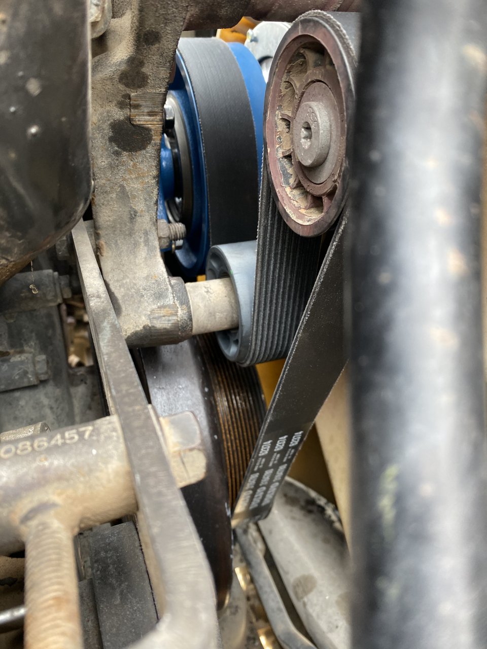

    Yessir. Got it all back together. Thanks to you all as always, safe trails (and profitable ones!)
    put a new solenoid, idler pulley and belt on for good measure. Did the test run (idling) and the fan clutch engages and disengages. Got a cool new creeper too from harbor freight for $39 . When I turn the key to the on position, it’s supposed to send air to the hub right?
