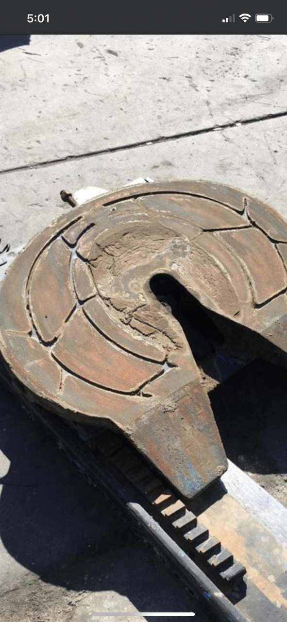

  8. Magoo1968
    Magoo1968 Road Train Member
    2,035
    5,432
    Mar 18, 2021
    St Malo mb
    80CBD2BA-276E-4E3C-AFFF-32B6E8F75F50.png My favourite style of fifth wheel except with grease on it . It’s so easy to check pin every time you get in truck. As long as you did a tug test checked jaws and pin is against fifth wheel it’s going nowhere so checking pin every stop verifies nobody pulled lever.
    spindrift, tommymonza and GYPSY65 Thank this.
