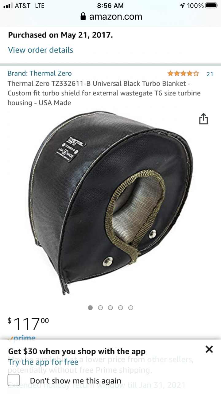

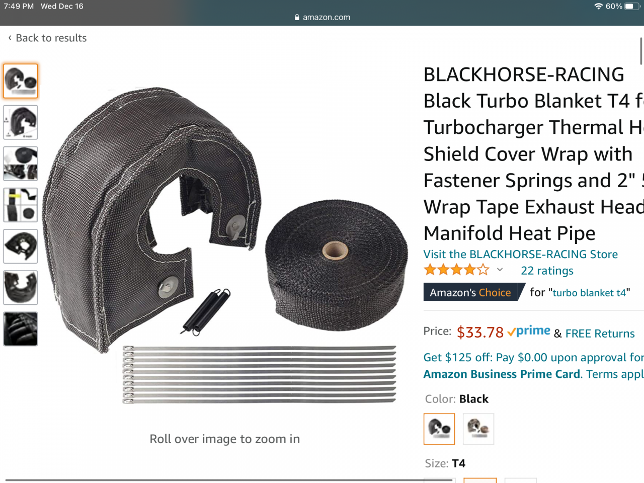

    How has this blanket held up so far? The reviews state they usually fall apart fairly quick.

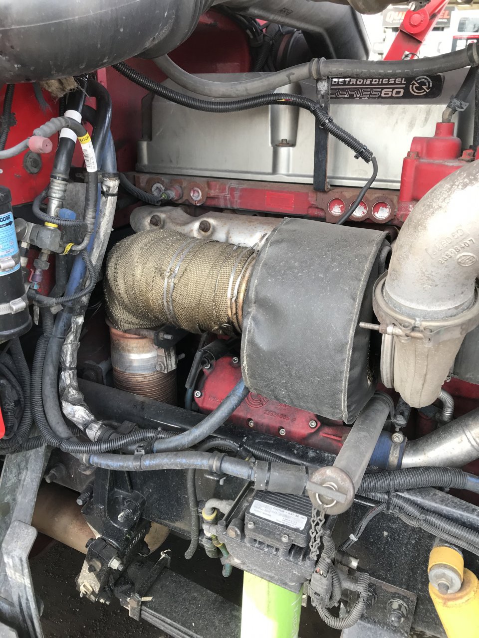

    I wasn’t at the truck when I posted that link. This is the exact one I ordered and it has held up very well. D97CD7AB-A388-4038-A712-5F7154A1ECCA.png

    21A946B8-51F4-429D-9325-C2FE8398255B.jpeg Looks about the same as when installed it about 3.5 years ago.

    Yes I have been extremely happy with it. Same results for me as you have experienced. The motor is dirty now because of the weather. I don’t let the truck wash clean my motor, I do it myself exactly for that reason. That pipe wrap can be eaten up quickly by a strong pressure washer.
