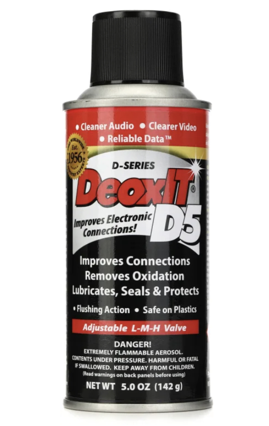

    Caig DeoxIT contact cleaner. Almost every time I’ve had trailer light issues, spraying this on the trailer contacts and into the pigtail has fixed it.
    JB7 Thanks this.
