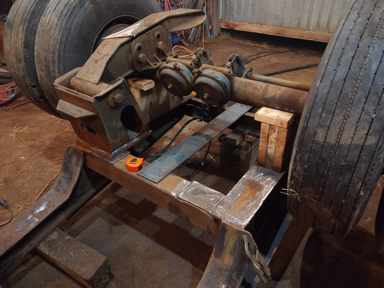

    If you need to use it every day then hands down a 4 axle truck is the way to go. But like you I need a relatively light truck 95% of the time and a lift axle on a truck built for it would hurt more than help most of the time. IMG_20180808_193519963.jpg

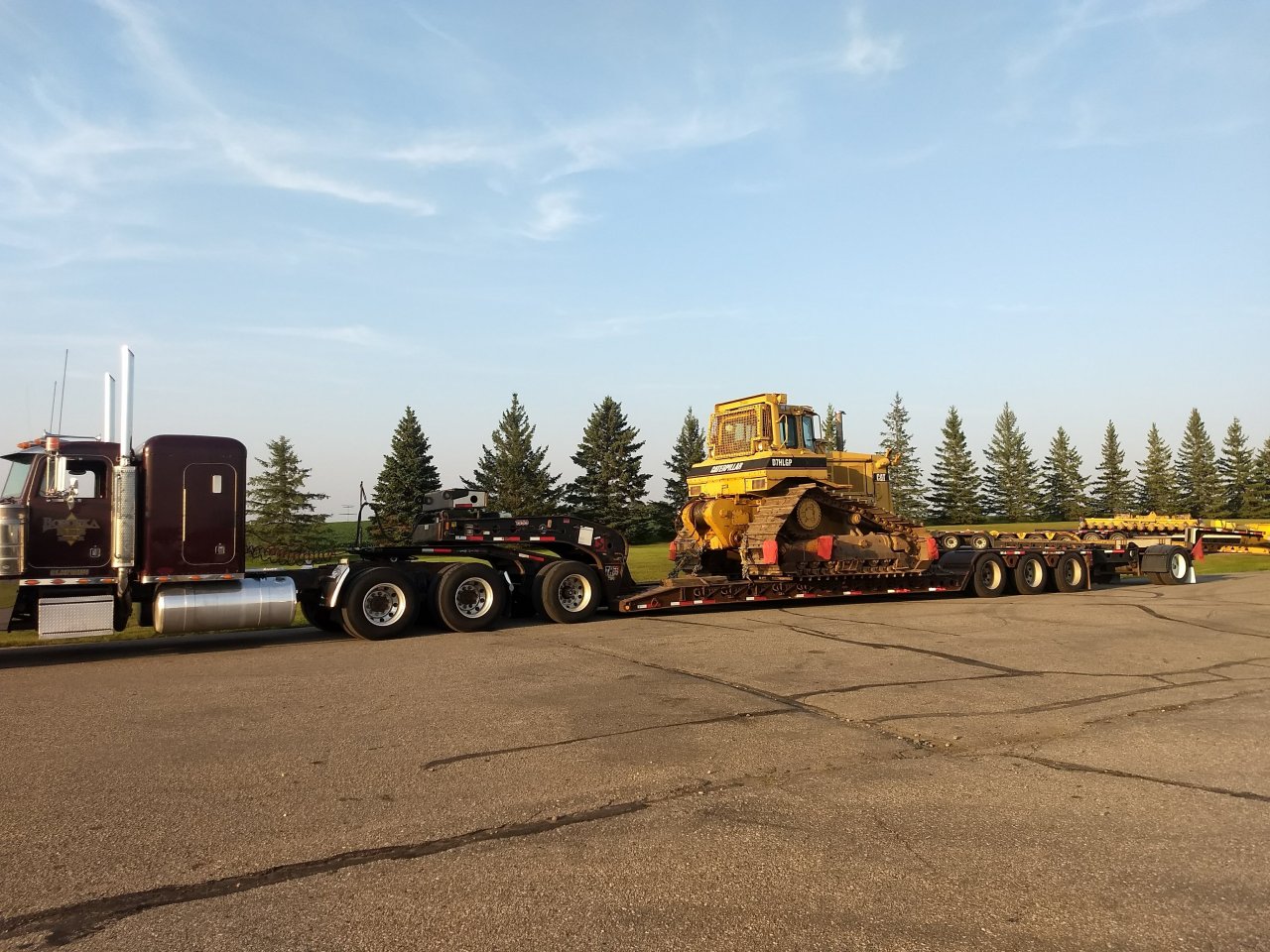

    If your going to go this route I would try and find a Canadian style jeep with rollers on front of the suspension hangers. And lift air bags on the axle. Then mount your long slider on the truck so you can slide the jeep clear up on the lowboy ramps when empty like this. IMG_20171104_120929387.jpg

    Right now if I'm in a tight spot empty, I just lower the neck. Chain the rear frame of the jeep to the neck. Pick the neck up and lift it off the ground. Walla it's a single trailer just 37" longer for 90° backing out of a job site.
    If you need more height just run the jeep up on some blocks first.
    A proper set of rollers that match the lowboy ramps is a really fast easy way to make it a legal when empty setup that's only a foot or more longer than what it would be without the jeep at all.

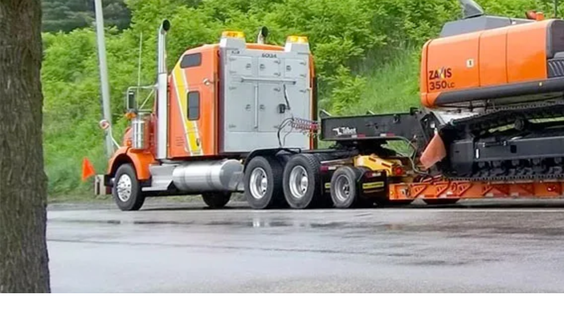

    There’s an outfit that runs out of Canada that uses a small tag that they connect to the back of the drives. Anyone familiar with this setup. I could never find out anything about these things but it seems like it’s almost like a “pin-on” E2F7531C-F062-4E08-99B3-1741DD0B5A82.png
