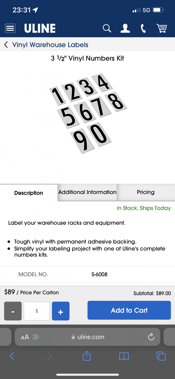

    Buy this! I been to numerous shippers that either acted dumb or, just didn't know so I educated them and charged them $25/placcard
