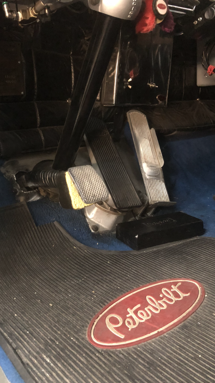

    You can see the wear pattern on these after 3,689,493 miles.
