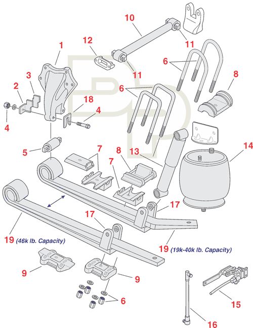

    I drove a 2009 that was the same way after numerous sets of drives and alignments . I went to Quebec shop and mechanic asked why we didn’t put the L brackets back on after doing bushings . We had never changed bushings the factory forgot them . That allowed axle to move side to side which kept chewing up tires and made it squirrelly to drive sometimes.

    @magoo68, I think you're onto something. I have the Airliner suspension and Stengelbros shows this:
    Items 2 and 3 are called "wear pads" and my truck doesn't have them. Are these the L brackets you mean?

    It’s been so long but that does look familiar . He took a pry bar and was able to slid axle side to side with truck lifted. Mine was ok bobtail too but loaded it was terrible if roads were rutted .
