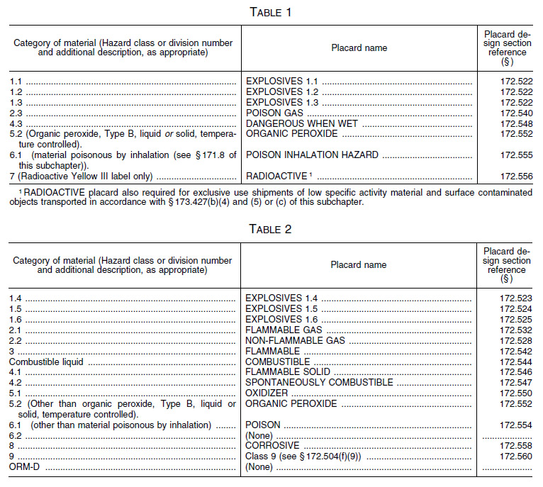

    Heres a chart that will help. Anything listed on Table 1 must be Placarded regardless of weight or quantity. Things listed on Table 2 only require placarding if more than 1000 lbs. Anything that must be placarded requires a CDL with hazmat endorsement according to the regs.
    Table 1 lists categories of hazardous material which require placarding no matter what amount of material is being hauled. Any quantity of hazardous material covered by Table 1 must be placarded, which means you must have a CDL with a HAZMAT endorsement to haul it.
    Table 2 also lists categories of hazardous materials and the placarding requirements, but there are some exceptions. The big one is, when hazardous materials covered by Table 2 of this section are transported by highway or rail, placards are not required on a transport vehicle which contains less than 454 kg (1001 pounds) aggregate gross weight of hazardous materials covered by Table 2.
