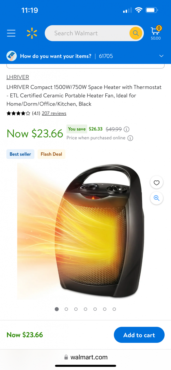

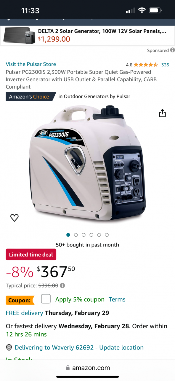

    That is a phenomenal value for what you get. ^^^ I just looked up the specs. 3.4 gallon fuel tank runs 18 hours at 25% load and with that much power you aren't going to be running nearly full load running a small mini split or air conditioner. More like 30-40% load tops.
    This mated with a cheap diesel heater and a mini split on a rig is a great idea, all for about $2500 vs. $14k for an APU? I don't see how it's even a question.

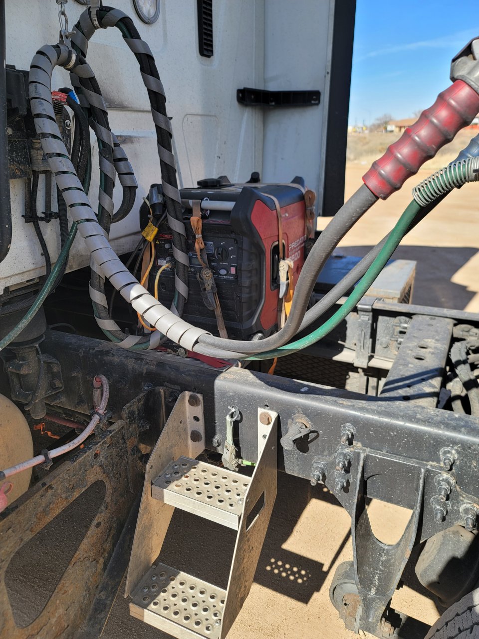

    Or better yet bypass the bunk heater for one of these and or a heated blanket. IMG_7538.png Been running like this for years. I run a 2300 watt unit on the catwalk on less than a gallon of fuel a night. Every night,,, for the last 5 years. IMG_7539.png Got an under bunk ac unit for the summer. Same 1 gallon a night… every single night

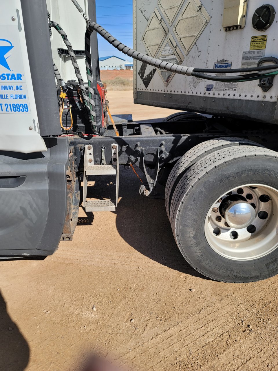

    This is how mine is set up. Slide the catwalk as far forward as possible. Move the hitch all the way back then turn the truck and move A LITTLE, check the clearance, move again and check do this very slowly and keep checking until you know it won't hit. 20240224_102846.jpg 20240224_103714.jpg 20240224_103816.jpg

    My 3,500 predator (starting watts) full load 2,800 watts, my 5,500 btu portable ac pulls 750ish watts. That's a 27% load. The 2gl tank will run it for about 11hr... 10hr south of I-10 in the summer
