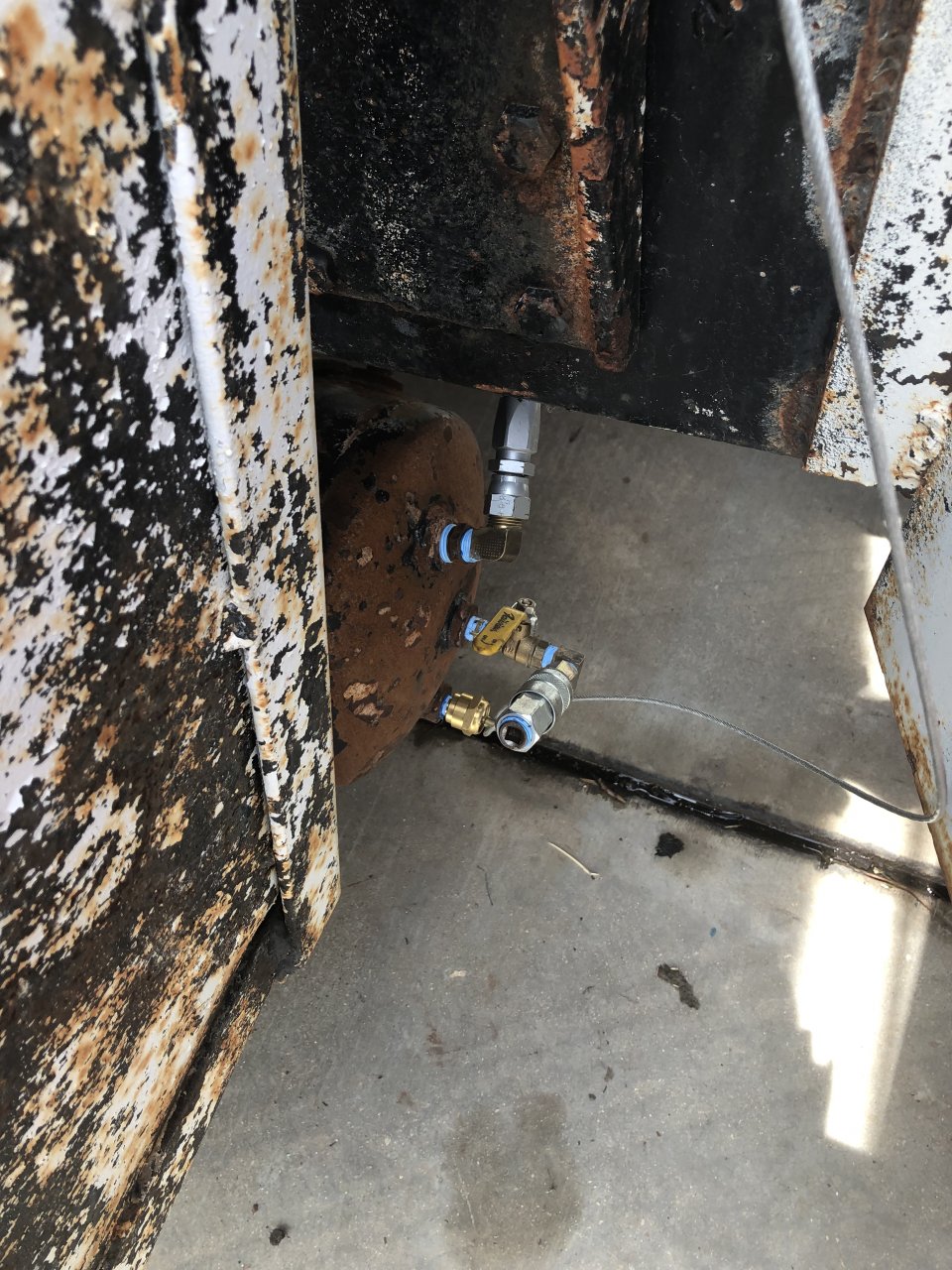

    Leave the air system intact and just pull a plug out of an air tank and install a “P” type air coupler in hole. Hook up external shop air hose and slowly let air flow in. The coupler will allow the hose to be disconnected and leave system aired up. 12C167B6-1B2A-4058-B859-DCFF22C7AFF3.jpeg
  8. SmallPackage
    5,441
    17,239
    Dec 20, 2019
    Marion Texas
    this is what i’ve done to the ‘65 White I’m working on now. I can air up the system with shop air. I can check for leaks, Release brakes, Use brake pedal and run anything that requires air without starting and running the engine. Works great for cold starts in the shop. I don’t have to wait 5 mins for compressor to air system to move truck outside while shop fills up with smoke.
