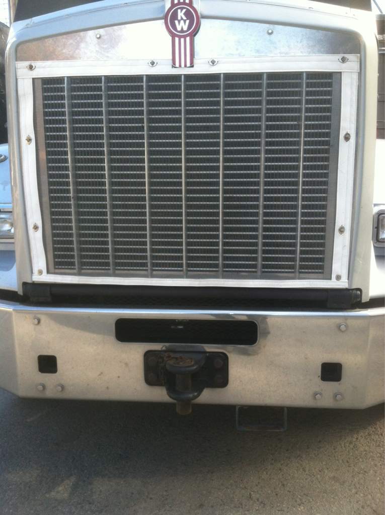

    After years of dealing with those crap factory tow hooks , I moved up.........[​IMG]

    Cat, that is the attachment I was recommending to the OP, glad you put the picture up. We have them on the front of our wreckers and they work great.

    Other then the bumper what is that bolted to?
  7. Cat sdp
    Cat sdp . .
    21,180
    75,025
    Apr 8, 2012
    Orion's Belt
    The bumper is cut out around it. It's mounted to a steel cross member and tied into both front spring hangers. Witch are also beefed up. Your in pretty deep if you break this set up.....
