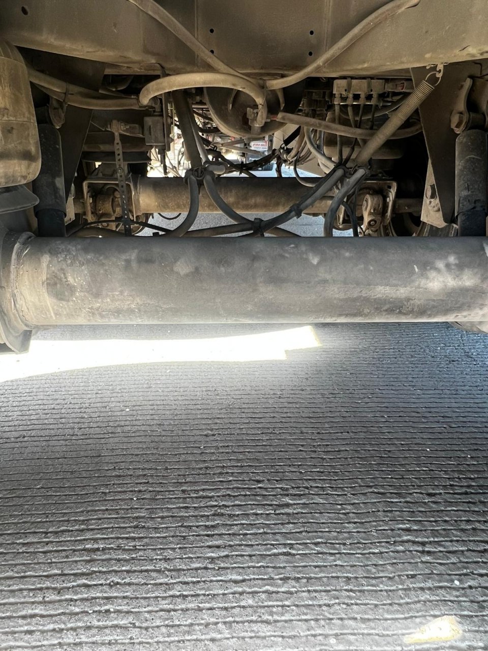

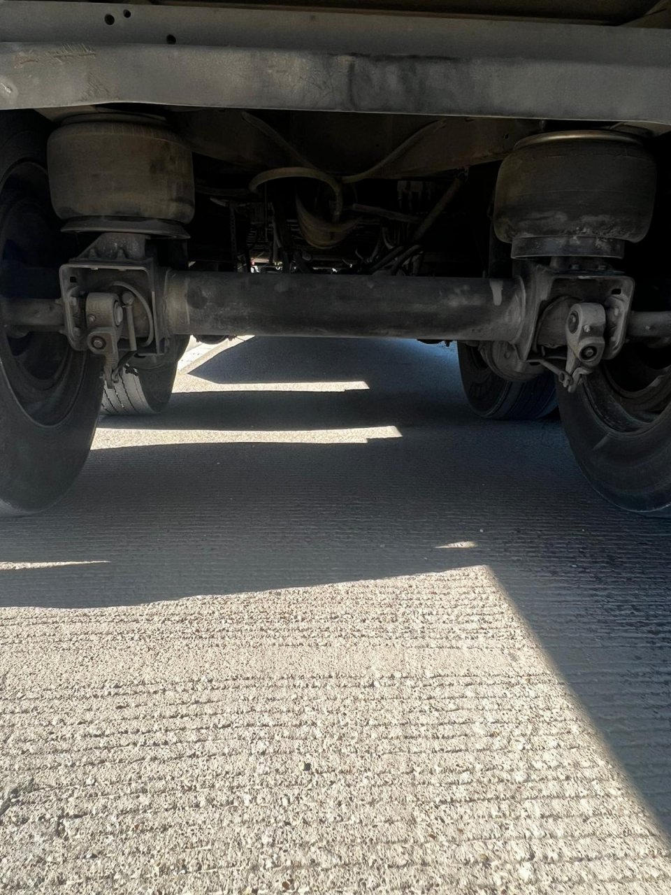

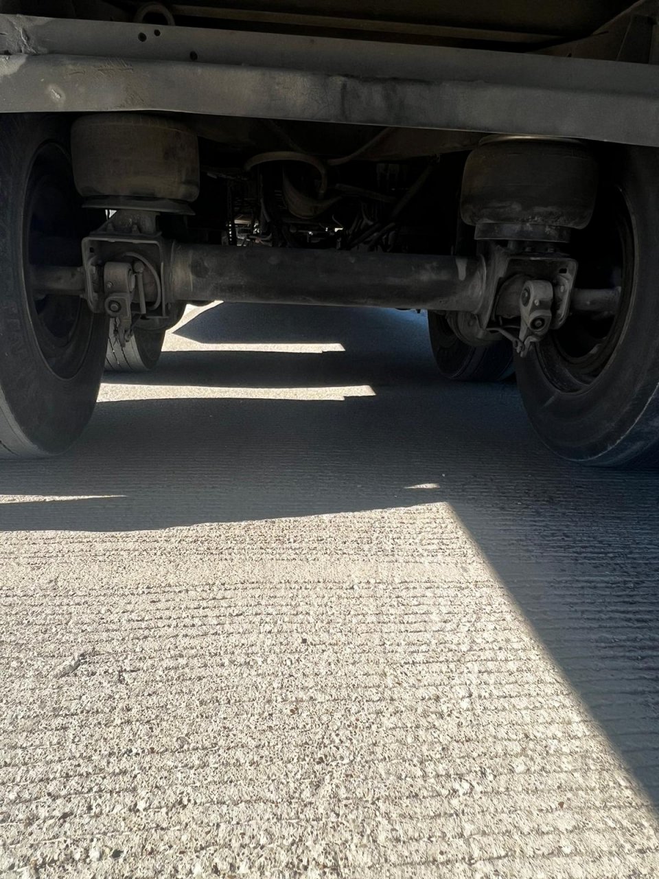

    When airbags are empty the right side of a dryvan trailer Lean on to of the tires. What can it be? Yes it’s loaded my my other dryvan not doing that. I changed the airbags. And didn’t fix it I put a picture of the other side. That is working properly. Thanks

    Looks like two new air bags on one side. The base looks different,is that the side it’s leaning towards?

    You have mismatched air bags. The left side has a flare base, the right side is a straight base.
    According to Hendrickson you cannot mix flare base with straight base air bags as it will give you different ride heights.
    You’ll need to choose either all straight base or all flare base, because they’re incompatible if they’re mixed.
    Replace the air bags with the base the came on your trailer originally from the factory and your ride height should return to normal.

    Yeah it was the airbags the plastic base was shorter. I didn’t know the trailer rest on those plastics things
