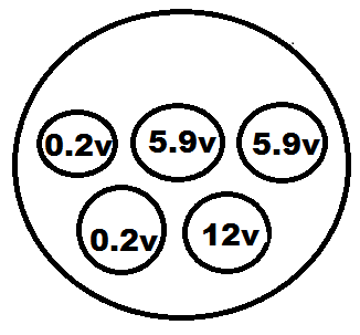

    my truck overheat due to no first fan speed not engaging. VECU has a lot of wires not sure which one to add terminal to . I know old air fan but this PWM completely cut me of guard because dont have any idea how to bypass it. here is my fan connector voltage reading. i know two grounds and one 12v and one 5v. but ive got two 5v on it. here is how it looks

    That kind of viscus fan clutch is progressive fan clutch and not easy to troubleshoot, like Pablo said it's control by the Engine ECU,base on truck that i have seen and road tested with the same fan clutch part number of your truck.

    im not sure what protective log is but no fault codes but here what ive found
    well i was all wrong. samehow ive connected fan to work on highspees all the time . and it overheats . soonest i heet some hills it will easy hit 218 or more on fan clutch second speed engage from the start if i dont pull over it will shut off due to overheating .
