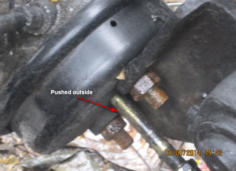

    If this truck has sat for a long time, another likely culprit is siezed up s cams. You need to narrow down the problem and give a bit more information. Take the pins out from the clevis on the end of the push rod from the maxi. Then you can see if the maxi pots are releasing. If the push rods go in and out as they should when the park brake is applied and released (good to have two people, one to pull and push the yellow handle and one to watch underneath). Then, if the pots are working ok, take a pipe wrench and see if you can move the s cams, or sometimes it takes a hammer to pound them back to released position. If they are seized you can try greasing and working them back and forth. They need to move freely (remembering there is a spring on the brake shoes). If you can't get them working freely, you need to take the wheels, and the drums off, and see what is going on. Try this, and let us know how it goes. Glad you got the steering figured out.

    I'm sorry, I am not really familiar with other terms so here are the actual pics. I don't know what to adjust. This is for the middle axle. The rear axle is working fine without any problem. It looks like the rod is stuck.
    Thanks for looking, and for help
