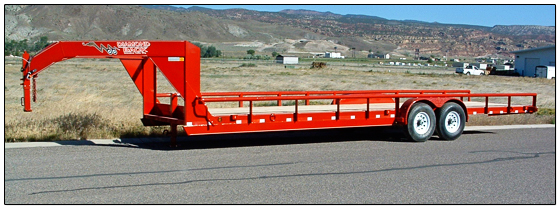

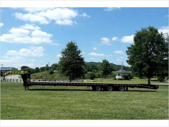

    Thank you for all the replies. I know the one picture I showed is a detachable gn, I don't want it detachable, I just wanted the same shape. I was trying to figure out how to make a lighter version of it. I essentially want this red trailer, mixed with the previous design shape. I want the raised deck portion lowered and the wheels moved to the back like a lowboy so I can have a trailer width of 8 1/2'. I decided to do steel framing for the tiny house which cut the weight down tremendously, total weight completed and furnished will be around 7k not including trailer. The reason I want lowboy style is because I need to have lofts and be able to stand. I'm 6'5", it will house my 2 boys , 14 and my youngest that turned 3 today actually, my wife and I. I'm not doing slideouts, I'm doing fold out in lower deck part like the video shown [​IMG]. this would be smaller and on drop section.

    The raising roof would be on loft parts at both front and back utilizing 4 electric actuators each with fold up wall to keep it lighter. Hopefully this gives a better idea of what I'm thinking. Basically this trailer built lighter and without detachable gn. I like the idea of using c channel frame. I was thinking of doing 1' height boxed in or c channel for the length with 8" cross members to drop floor down further for interior height.

    If I could mix the lightness of the red car hauler trailer with a lowered deck over on front end as well as the the low center section. Trailer will be shrunken from semi style like it is to basically a 32'-36' (that's not including the section over the truck) Rv 5th wheel size trailer with a total length of 44'-48'. I hope this all helps to gives a better idea of what I'm trying to do.

    I have thought about just modifying a 5th wheel Rv frame by removing axles and adding an extended section on back to drop the frame down like a lowboy and modify the front area with a gn attachment to have the front deck of trailer sit just above my truck bed about 6" or so.
