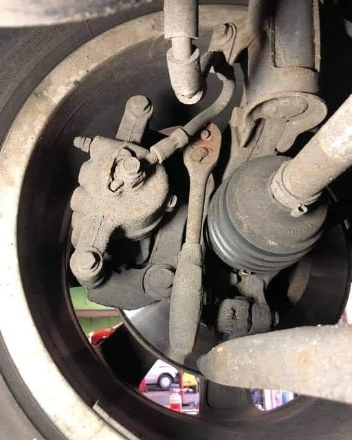

    Top quality brake job right there. Made sure caliper mounting bolt was tight.

    That’s the manual disc slack adjuster made by Snap-on.

    $500.00 specialty tool right there.
    But seriously surprised it was still on there it looks like it had been awhile.
