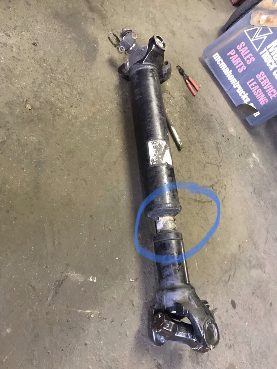

    That joint is bad. No needles left. Do not run it until you get repaired. Check the others on the shaft closely while you have it out.

    Thank you so much. I will change it tommorow. I can’t beleive that some mechanics are saying that u joint is good. Thanks again. Have a blessed day!

    Many trucks have non-greasable slip-yokes that can seize up. If you have the drive shaft apart, make sure to check the slip yokes to make sure they slide freely.

    Like @Goodysnap says, looks like that u-joint has failed. Hard to tell from the picture but there definitely looks like there is an issue with that bottom bearing cup. 2nd @Heavyd's suggestion as well to check the slip yoke once its all apart.

    Hey fellas, I’m back here. I have to say thanks to all of you who tried to help and solve my problem. Today i bought U-joint from Volvo which cost me around $200 and took my truck to the shop. The U-joint was bad and also the driveline was stuck, after i left the shop no more vibrations and feeling like the transmission is going out. Here i will post some pictures from both the driveline and u-joint.
    Symptoms: vibration, clunking when tried to start, squeiking noise. If some of you truckers have those symptoms it might be u-joint. Don’t doubt just change it. Cheap part can cost you a lot. Thanks again to all of you.
    Btw the second pic shows where the driveline was stuck because of some plastic.
