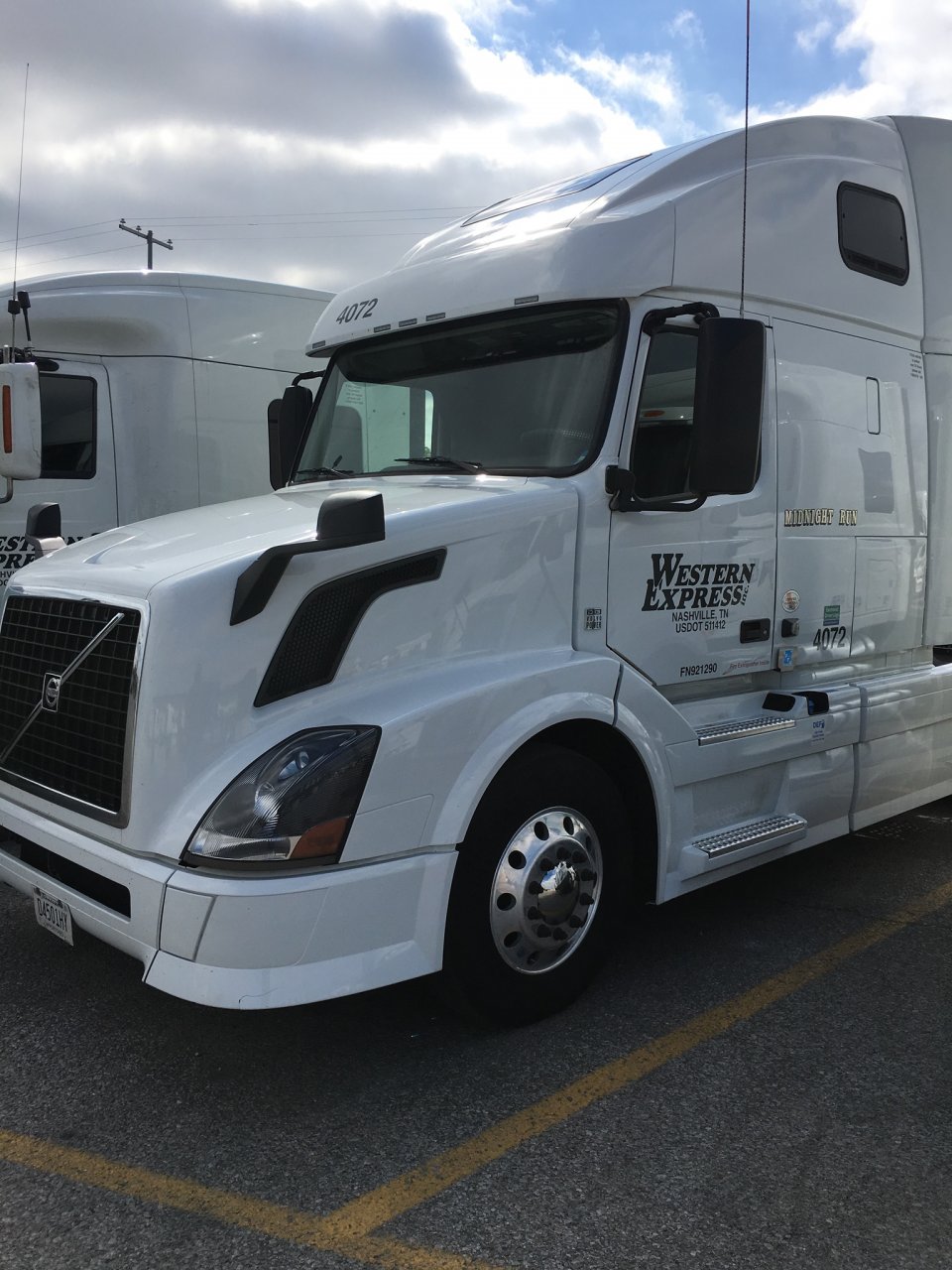

  7. mjd4277
    mjd4277 Road Train Member
    14,333
    43,661
    Oct 4, 2015
    Fitchburg,MA
    The Volvo I drove had its shutoff switch located on the outside below the drivers side door behind the access panels for the drivers side body fairing.
    Basically you pulled up and turned two black handles to release the locks on the fairing,pull the fairing down and you see the switch right above the batteries and the battery tray.
    tommymonza and PacoTaco Thank this.
