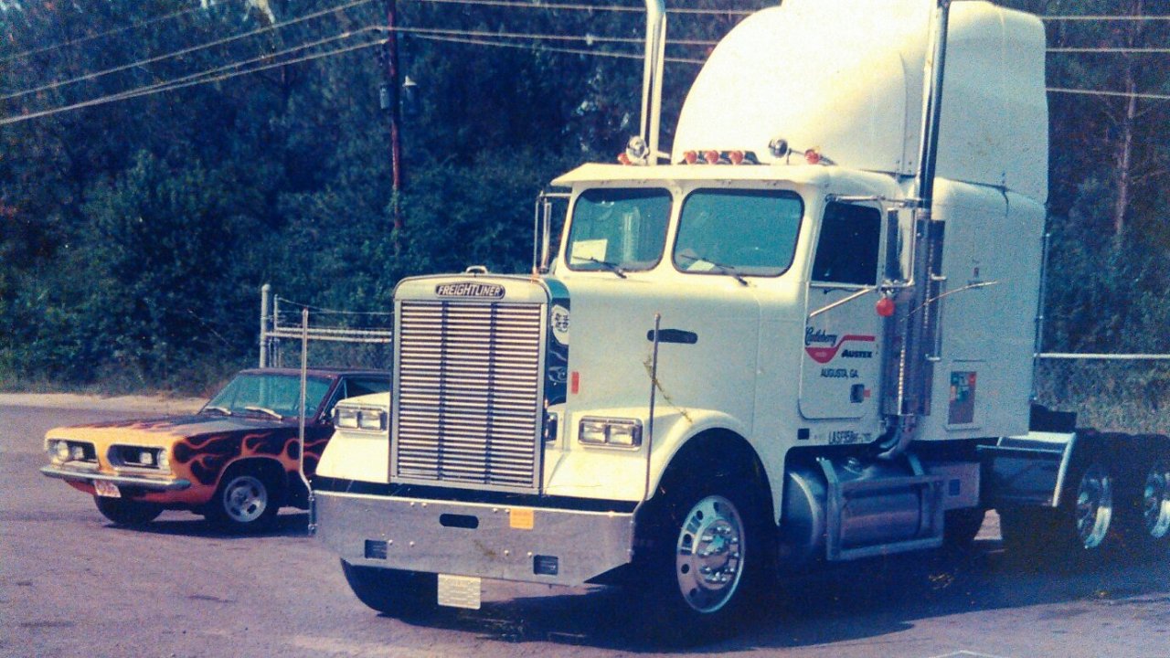

    A lot of good information on this post so I will share my two cents. In the picture attached is the truck or one of its sisters parked by my car KIMG0925.jpeg I was working in the shop 2nd shift. Driver reported the alternator was bad. Voltmeter reads low and the head lights are dim. The truck did not have 100,000 miles on it. The alternator and starter had already been replaced. Seeing that I pulled the file to see what had been done to it. It had already had something like 5 alternators and 3 starters along other electrical work.
    With the engine running and every electrical devise on I started doing voltage drop tests. Found the meter read a good bit of voltage between the frame and cab. The cab ground strap was near the steering column. The cab had been under coated before the strap was installed and then undercoated after it was installed.
    You cannot see many electrical problems. The best way is by testing not trial and error. Voltage will very some along the way and testing it without the engine running is an interesting idea. Some volt meters were connected directly to the alternator and will read different than voltages most other areas when running. Test both sides + and -. Hope that helps along with the other posts and you get that worked out.
