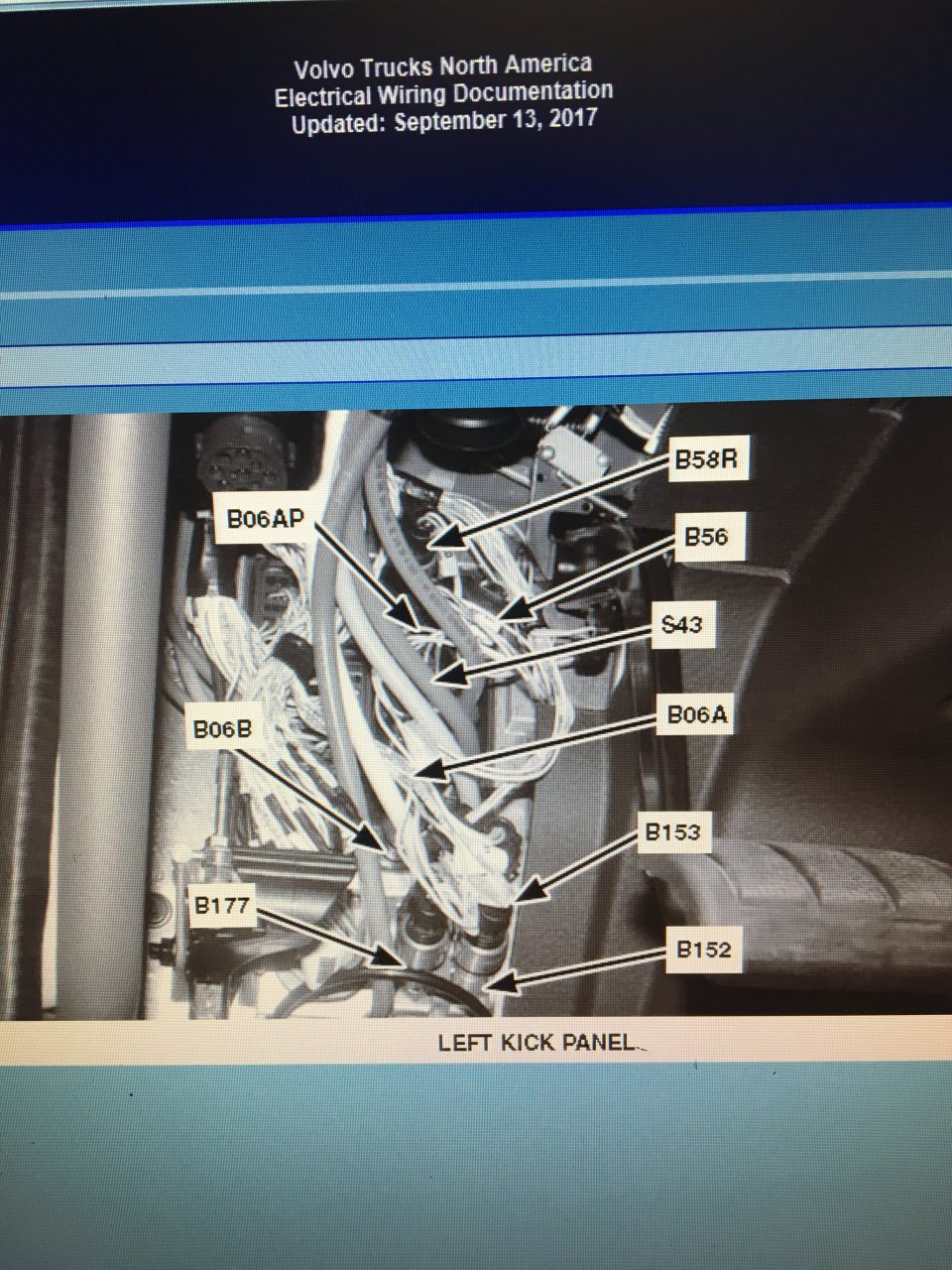

    There is two sensors for rear suspension pressure. The one on very top left if you are looking from the cab is rear suspension pressure for instrument cluster, marked as rear suspension pressure.
    The one which is for ABS module is on the very bottom left, marked as D2.

    Nice. I was going to send you this pic which shows the same thing but wanted to make sure it was valid for your build date. B58R is one but B177 is the one that signals the Bendix ecu. At any rate. Good find.

    Thank you. Very helpful picture. I figure out it by looking closer on the firewall from the engine side. There is T-connector for rear suspension airline to split pressure between two sensors. really hard to notice behind all wires and airlines.
    And one important things to notes. The damage was made couple months ago when I was searching for air leaks and sprayed firewall air fittings with dish soap water. Some water got inside the plug and cause corrosion.
