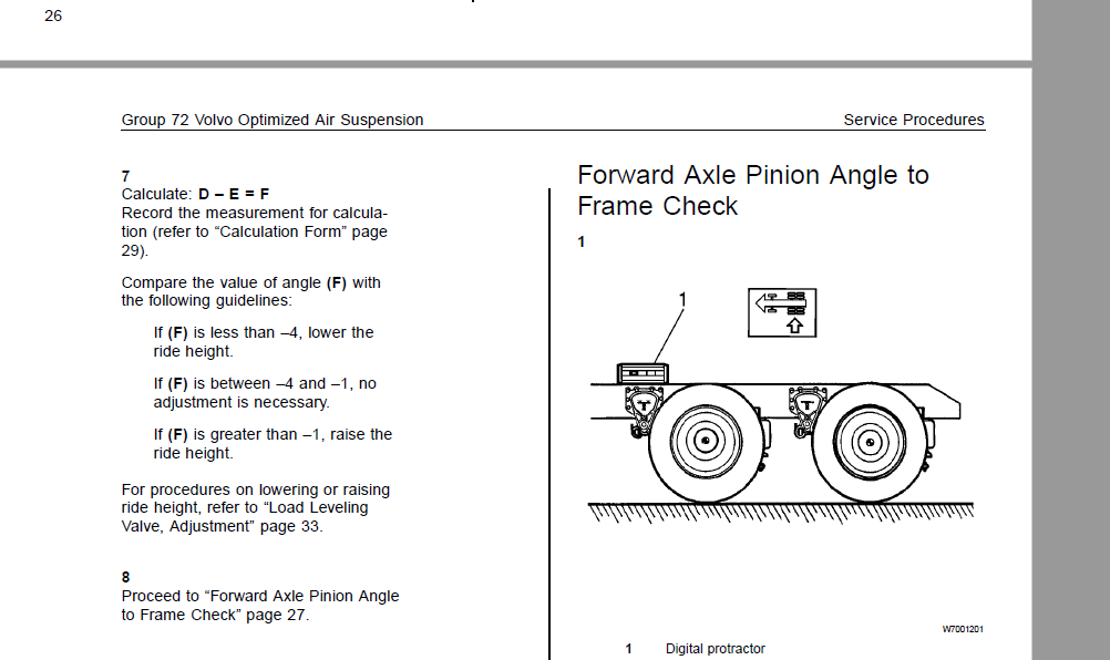

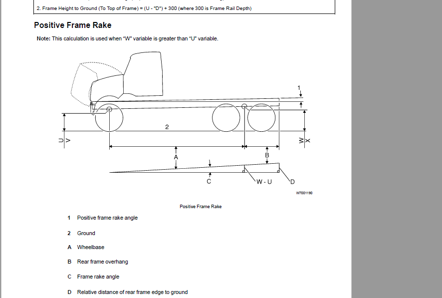

    After reading what you did to improve riding i can say front suspension sprigs are flattered. Truck is leaning toward front or in Volvo words positive frame rake. More fifth wheel load will increase frame rake. Moving fifth wheel back to unload front axle will cut ability to take 80,000 as 10,000+34,000+34,000 = 78,000.
    Here is what you need to do:
    1. Calculate ride height for your truck
    2. Set the ride height.
    3 . Check pinion angle and drive line angle.
    If angles are out of spec readjust ride height till angles are right.
    2018-12-22 19_57_55-Air suspension settings.pdf - Adobe Acrobat Reader DC.png
