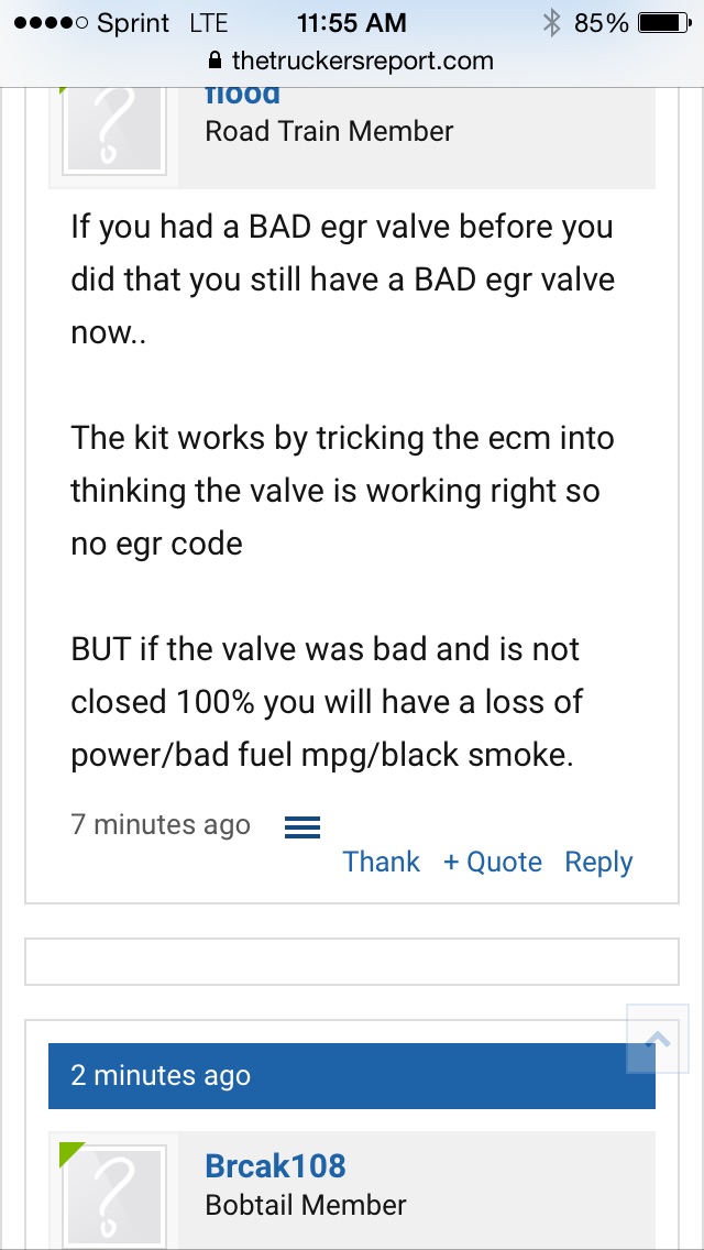

No check engine i think i will just take egr valve off and see maybe it stock open who knows somebody told me if you had bad egr before nd installing this kit egr is not deleted 100% if is stock open i will just weld it i hope thats the problem if not i dont know where else to look
I did check both egr valves when i installed the kit and they both was closed but somebody told me this
Yes that is true. Your egr system has to be working properly when you install the OTR kit.
