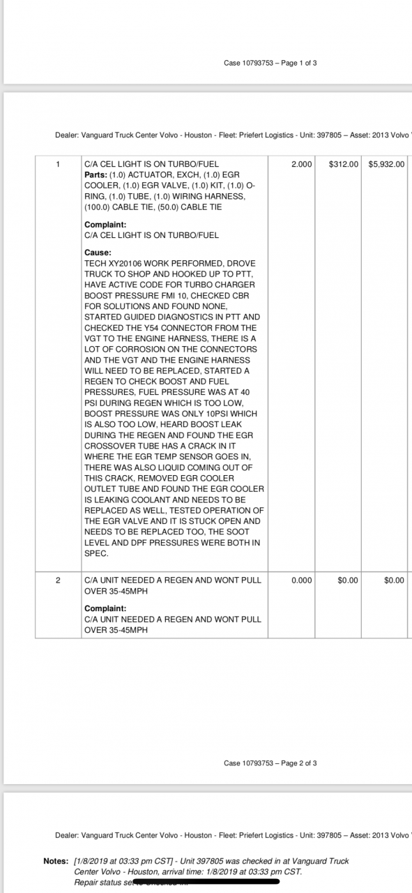

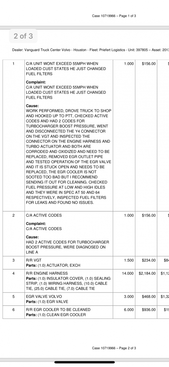

    This is what volvo said the first time
  4. nasriza
    nasriza Road Train Member
    2,398
    2,074
    Feb 1, 2013
    Chicago, IL
    when did you have this work done cuz from what it looks like they already replace your VGT.

  5. Tcainmayne
    Tcainmayne Light Load Member
    55
    11
    Dec 20, 2018
    No it was recommended but I didn’t do it because of money issues I just replaced the egr cooler and egr valve which helped for 2 weeks

  6. Tcainmayne
    55
    11
    Dec 20, 2018
    This is the new invoice Volvo just quoted I hope the crack in the egr cross over tube is the problem

  8. Tcainmayne
    55
    11
    Dec 20, 2018
    Yeah I know i just wanna get rid of this bs at this point they gotta replace the egr cooler and egr bs again after 1 week of driving it glad it’s under warranty hopefully that pipe was the cause of my boost leak
  9. Tcainmayne
    55
    11
    Dec 20, 2018
    Do anybody know if I should replace the turbo actuator and the engine harness at the same time or can I fix the turbo actuator first volvo said they wouldn’t recommend them doing separate because it can still mess up the acuator if I don’t do the engine harness together???
  10. Newto Trucking
    Newto Trucking Medium Load Member
    359
    225
    Dec 26, 2013
    NE Illinois
    85130713 that’s Volvo part number for VGT Actuator connector
    KB3MMX Thanks this.
