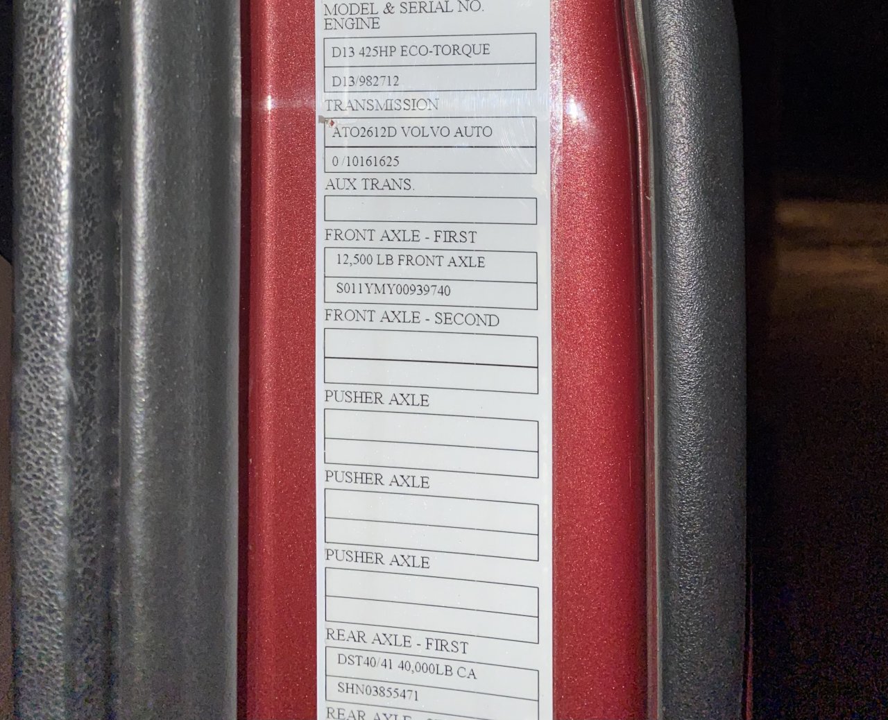

    Hello, hope u guys doing well. I just got this truck, and I understand that doesn't have a lot of power, i did this week east side, and i drove it with 40-50 on the hills bc i had a heavy load and the temperature was between 180-200. If i want to upgrade it, from your experience how much it will be the best, and do i have to change the Torque? If yes which one is the best, And radiator fan stays always running, do i have to check anything about that? Thank you and happy holidays

    What is the torque at Now? 500hp and 1850 torque will be the max the dealer will do.
    How many miles? The fan kicks on at 211F and should cycle. It should Not stay on constantly.

    Idk how to see it, i have no idea... its 616K rn. I know thats why i asked about the fan
