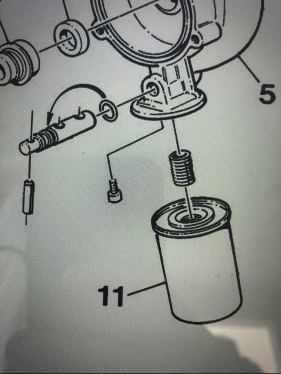

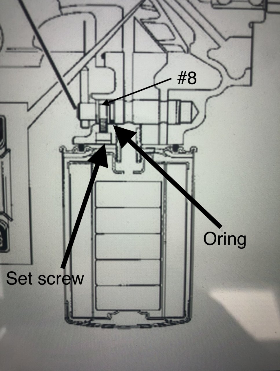

    The o-ring and new compression fitting on my D13 was only about 8 dollars if I remember correctly. The expensive part was buying the quick-connect hose fitting that drains the radiator at about 75 dollars. Once I figured out how to remove the valve, I made the determination to replace the parts on it each time I do my coolant.

    Wow yes, I’m wondering and almost getting heart attack before I knew the valve can be removed like that easy, I thought I need to remove almost half of engine to replace the coolant filter housing it’s pain in....
    but thank you , you are really life saver so I will need to do only drain the coolant remove the filter to get access to the nut under filter loos the nut to remove valve and replace the ring , thank you
