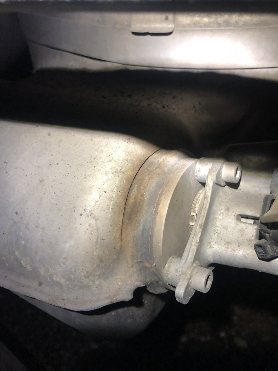

    You might be loosing temperature between dpf outlet and scr inlet. The temperature you see on the dash is from the sensor on a very top of dpf filter assembly, right before all the filters.
  6. Newto Trucking
    Newto Trucking Medium Load Member
    359
    215
    Dec 26, 2013
    NE Illinois
    This could be your problem. The best way to check it is when you do parked regen, remove passenger side fairing and a black metal cover that is secured with 4 nuts 2 on each side. That will give you an access to see it better, then 15 minutes into a parked regen, when the temperature will be over 600F you will see if you have the same crack. I put my fingers over the crack just to feel the flow thru the crack. If you have one you will be surprised how much it blows thru it.
