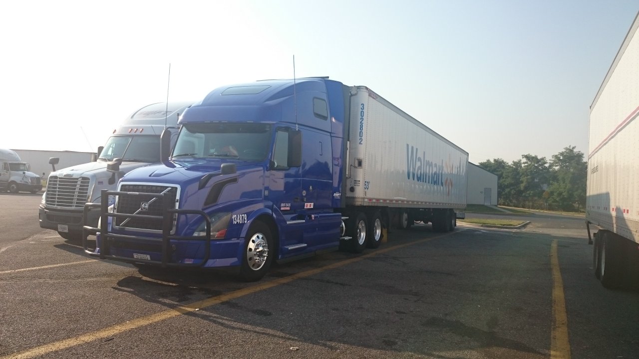

I cant go more than 4 months without injector/cups hardstart symptoms....thinking about junking this engine and shoe horning a cummins down into the truck. Volvo should be embarassed by this piece of crap.

Crappy thing is I just finished paying it off, swapped a 13 speed road ranger into it and installed a brand new TK tripac on it. Once the truck is started, it runs like a champ. Pulled 45k lbs of paper rolls up Monteagle the other day going 50mph. Volvo said my boost pressure is a bit high, 45psi, but turbo checked out alright and looked like new inside. Aftertreatment system regens as it is supposed to, soot levels stay low. 7.9mpg lifetime fuel economy on the truck. Idk. Guess I am screwed paying $4400 a year for a part that should not be failing.
