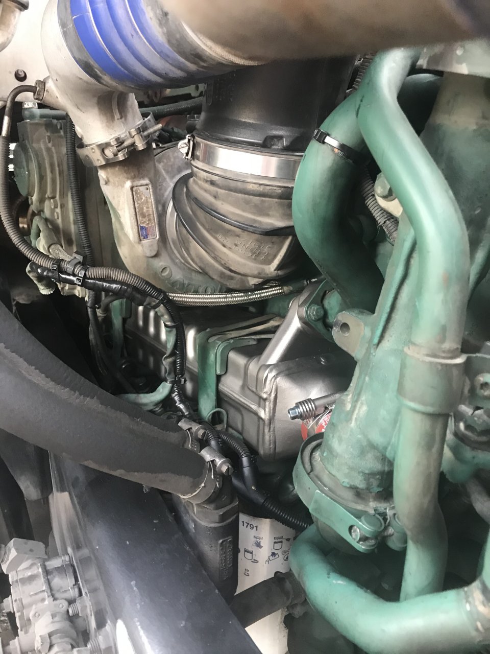

    Well, tackled the r/r of the egr cooler yesterday and just wrapped up filling coolant back in and ran it for about 30 mins. No leaks anywhere that I can see. Really hoping that was my issue. Job wasn't too bad, the most difficult part was reaching the back turbo bolts. Thank you all for advice on this project which saved me a couple grand in labor! 733EBA03-406C-459F-A520-2C0ECE438A64.jpeg B0F1E6FD-4523-4476-A770-C56F6311AD0D.jpeg

    Just a quick couple month update. EGR cooler was defective and everything back to normal! No losing coolant anymore! Thanks for the advice and help everyone, have a great day!
