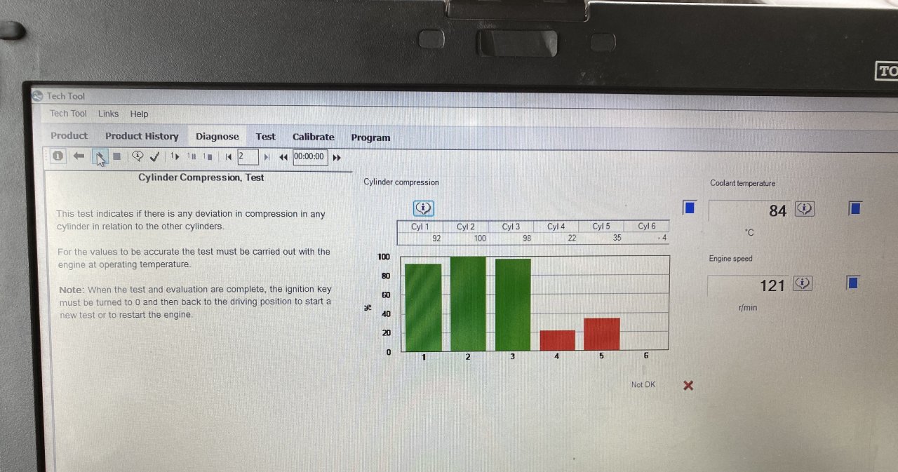

    Have you ever seen something like this, what do you think is going on with this d13 engine?
    QUALITYTRUCK Thanks this.

    Hey Jay. I have a dd13. Cylinders 1, 2, 4 and 5 reading mid 60 compression. Cylinder 3 is 100. Cylinder 6 -36. Took head off, no issues. Rough idle. What should we check next?
  11. AModelCat
    27,742
    145,384
    How do they get a compression reading electronically like that? That's a first I've seen. Always done it with a gauge.
